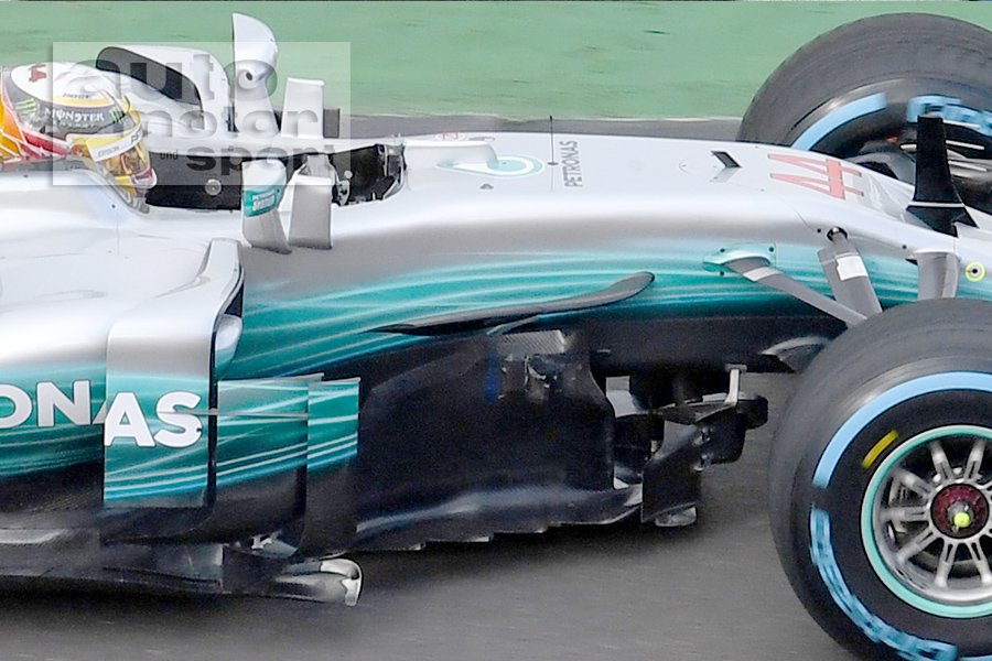

Tire Squirt Slots, Sidepod Turning Vanes, Bargeboard (Bargeassembly?), Batwing, Front Suspension…. There are some really cool Features on thar Car already. Also it looks quite long.

Very developed barge boards as expected.
Regular lower wishbones for the front suspension.
The exhaust cooling is similar to what Mclaren used a few years ago.
Front wing retains the large 'tunnel'.
The sidepods have a nice undercut.
Big sweeping wings on the front chassis before the sidepods.
Small sidepod openings.
The outer edges of the diffuser have a similar profile to the outer edges of the front wing, to spread/expand the flow outward.
They opened up a lot of area by the floor to allow flow around the pods and to the rear.

Leading edge of the floor curled up and fins there?

It looks like the center section of the diffuser dips down a bit instead of the entire top being flat.
