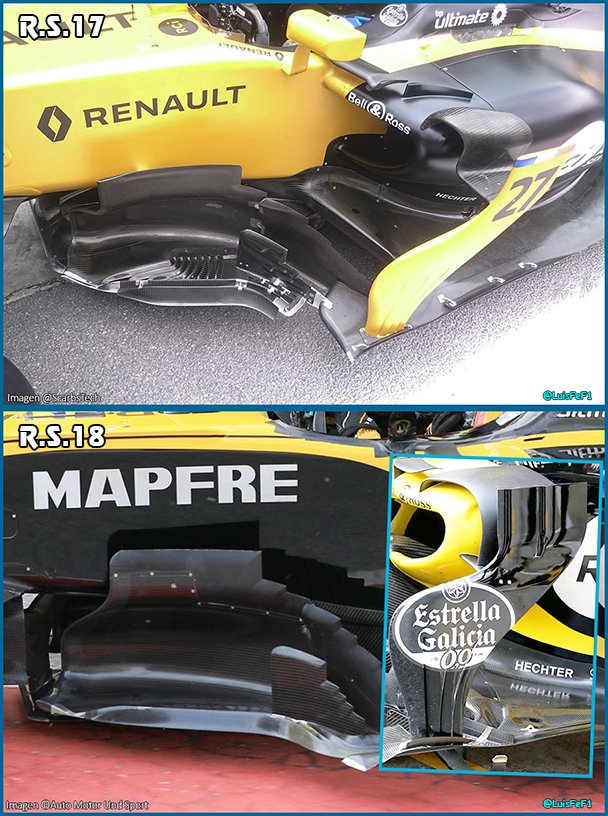

What are the slots in the horizontal lower portion of the barge boards doing? It seems this is a development that all cars are taking. Are those slots cleaning up the disturbed flow behind the wheels, or creating a stronger vortex along the barge boards?

I would think part of what they do is channel more air to the floor. If you look at the slots and leading edge of the floor they are shaped to catch air, in the style of a ground effect craft. Which is really just a diffuser that travels backwards.

It's a common misconception that lift is bad on an F1 car. Lift in the right place can actually produce more downforce, and the mid-chassis is a region the designers want to create lift. Starting at the cape/batwing/whatever under the nose to the bargeboards and the side pod leading edge flaps (SPLEF). Creating downwash, with an outwash, in this area is useful to push the front wing, suspension and wheel wakes away from sensitive parts of the car. It also will draw cleaner airflow from the top of the chassis down into the cooling inlets and around the sides of the car. It's another misconception that the high noses (2012 not 1991) were to get more air under the floor, instead it was to get more air under the chassis to work the outwash devices.
godlameroso wrote:
20 Mar 2018, 14:46
I think you're seeing patterns/similarities where they don't exist. In that ground effect craft what you have are two buoyancy pontoons on the ends of the 'wings', for landing on water. The wing doesn't work like a diffuser, instead the main 'ground effect' is ram pressure rather than the venturi effect. I assume you're comparing that to the hammer head (the small wing shaped element at the end of the bargeboard) if you look at the direction of flow it's fairly simple to see that's pushing air away from the floor, curling it upwards, along with the scroll at the side of the floor, away from the underbody. It's better to consider the bargeboard as a turning vane, changing the direction of the flow. The complex cutouts in the footplate of the bargeboard will create vortices which travel under the floor, it's going to help flow remain attached in the diffuser. This is one of the best images I've ever found for describing the flow from the bargeboards under the floor. It's a little old now but the same principals will be adapted for the current regulations.

The floor of the barge boards with all the slots send air downward, and the leading edge of the floor is raised, if that craft flew backwards it would get sucked to the ground. Build one yourself with cardboard and glue and see for yourself.
Look leading edge of the floor on the FI is also raised, I bet they all are, and that raised area on the side of the floor behind the side pod endplates is probably a diffuser. By lowering the pressure in the leading edge of the floor airflow will favor entering via the floor thus providing more energy for the main diffuser at the rear.
