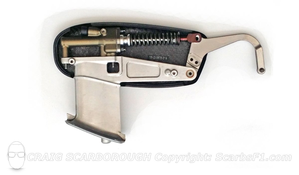

Thanks but i’m still scratching my head on this, spec part or not, from the images of the actuator clearly looks like it can open more than the 85mm otherwise how did teams get caught out on it.
Although some claimed the part was defective it shows it can be opened more to a point where it’s creating lift on the rear.
Let’s say if 85mm reduces drag by 25% then even 2mm extra gap could give you over 26% drag reduction. Maybe worth like 5kph. The actuator arm looks it can be adjusted. You could also pivot the mounting points to get the flap even more flat.
Given the amount of electronics and electro hydraulics on these cars, it would be easy to program it to open more than the allowed amount. Just saying.

yamahasho wrote:Thanks but i’m still scratching my head on this, spec part or not, from the images of the actuator clearly looks like it can open more than the 85mm otherwise how did teams get caught out on it.
Sorry, but no it wouldn't. This is literally not possible, because the actuator always moves 100% of its travel length. It's a pull-mechanism, and it cannot pull beyond its allocated length without breaking, no matter how you program it.
Also, any electronic had to go through the FIA ECU. FIA has access to all the data and software.

I can see if the FIA has complete control over the parts so no one can disassemble it but if a team can fiddle with the mechanism there are so many ways to get more travel out of the actuator pictured even with no programming.
You could enlarge or reposition the holes, put in a smaller height piston, bore the end of the piston chamber to give it more travel, angle the mounting plane and adjust movement of the piston as needed, you could make the arm flex, I could go on.

yamahasho wrote:I can see if the FIA has complete control over the parts so no one can disassemble it but if a team can fiddle with the mechanism there are so many ways to get more travel out of the actuator pictured even with no programming.
I’m think it there must be some measurement sensor the FIA regulates.
But that would make the wing fail the test. The entire construction of the wing has to be able to withstand the FIA test. If the DRS actuator can open the wing more than 85 mm (because of manipulation or whatever), then so can the FIA test, because it's not just a measurement test, but it actually applies physical pressure to the wing during the test.
I agree.
I would do something like this, assuming the actuator can be disassembled. Just add stopper pistons within the chamber to stop the piston moving more than you want it to. Or a bit more complicated would something like this.
Just use a series of valves to bleed out the 2nd chamber when needed and fill the 2nd chamber back up for the static tests. This is not something new, if I recall, teams were bleeding their shocks after qualifying to raise the car up for heavier fuels loads.
But if its a spec part like you said, then all bets are off.
