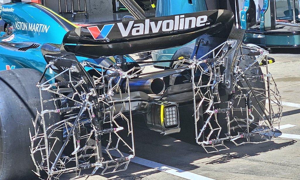

Re: Aston Martin AMR24
That's an old rear wing I think, perhaps for better data comparison with the sensor arrays
