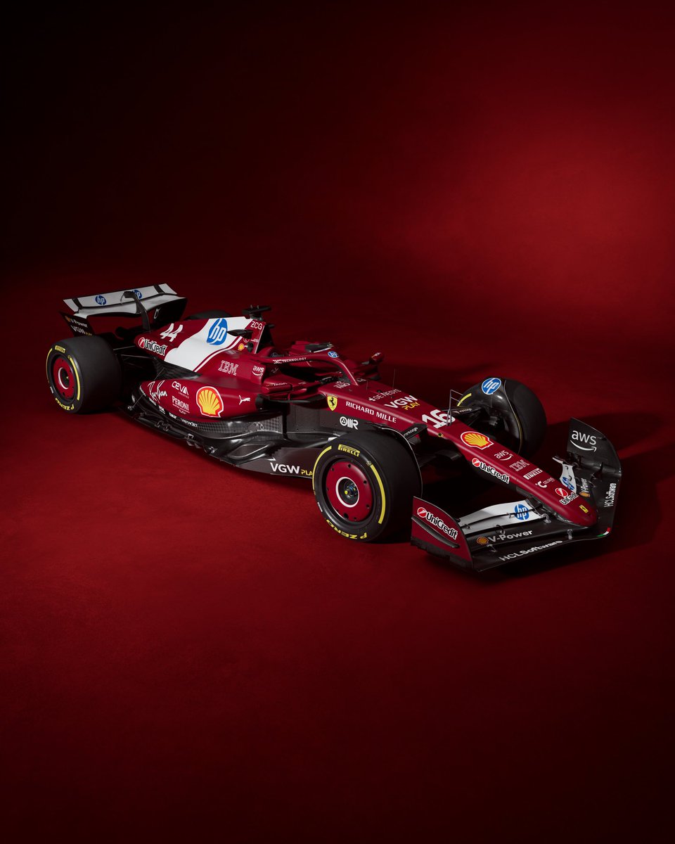

The switch from a front push rod to a front pull rod configuration is massive. It's easily the biggest change between all cars this season. Will it provide performance ? I have absolutely no clue.
Serra confirmed it was done for aero reasons, as expected.

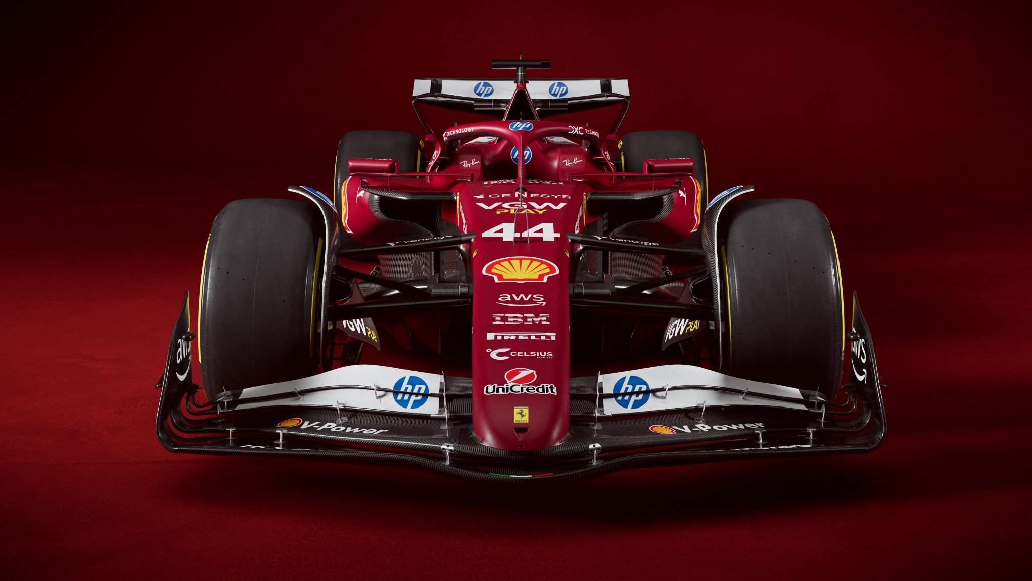

Those look like interesting cooling outlets. I'm sure I am wrong though.

Is it just me or is the overbite significantly longer than last year?

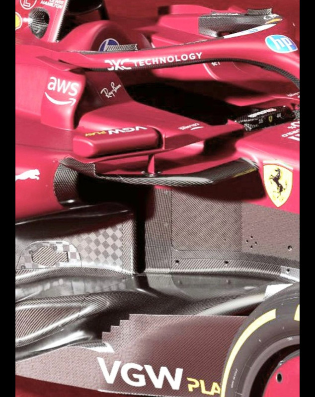

Interesting serrations on the outermost vane and a different vane arrangement/layout:
Sidepods seem less bulkier and with an indentation from the top. So it seems like they're not entirely flat before the waterslides like they used to be before, instead now there's a bit of a "dip" from the outer edge. But overall, I would say it's the same philosophy?
The overbite lip of the inlet is very similar to McLaren, but Ferrari retains their inlet design.
Engine cover seems tighter, but can't be sure without comparison pics at this moment.
A side by side (SF24 pic from motorsport)
