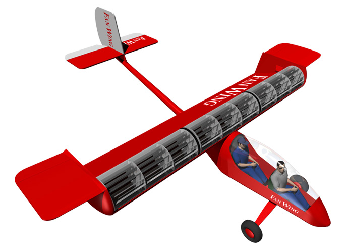

Another (less biomimic perhaps) wing idea I've been following is FanWing (link). Seems interesting enough, and there's also a related idea (currently being promoted in Korea) called Cycloidal Propulsion (link).
Picture from FanWing.
