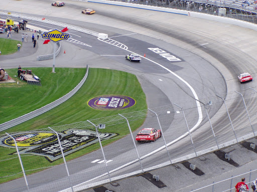

Oval racing is cool to watch this happen. If you look closely at a NASCAR race, I know alot here don't care for it, you can see the tracks the tires leave as they bomb around the corners. They are sticking to the rubber that is worn off the tires in a very thin amount on the surface of the track.
You can see it pretty good here too if you zoom in to the left.
