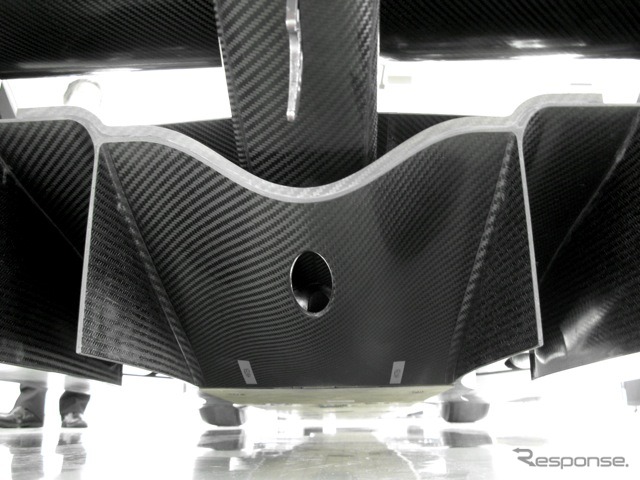

DD illegal? 8) No big deal! slap some carbon under that floor: seal up the side holes, and you have yourself a single diffuser car, ready for 2011! Small feat compared to building a new car.

Well it is certainly a good option for the team to do these cheap tricks. The behaviour of the car might be a bit of surprise though.
As the single(patched up) diffuser out back will mean less downforce. This will move the centre of pressure forward (correct?) based on the smaller diffuser being less able to extend the lower pressure region of the front splitter rearward....

You'd have sub-optimized car as a result. The packaging of current designs is made with DDD in mind (e.g. inclined Ferrari engine, raised gearboxes etc) and if you're not having DDD channels you'd better re-pack everything otherwise you'd have higher CofG and probably rear end would be not too effective aero-wise.

donยดt forget others have to close these entries too so loooking back to 2009 you could say half a second was the minimum gain of having this item.
For me the reversal of this process can only have as consequence for an optimised solution you would have to lose half a second getting rid of the ddd or in a non optimised situation it was say 1.5s....comparing this to Lotus,Virgin,HRT still quicker then them,right?

Has this feature been used by other teams? What is it for/what does it do?
