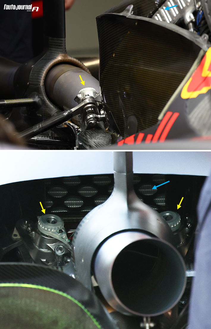

Nicolas Carpentiers:
Rear pushrod suspension and central cooler on the Red Bull RB18.
