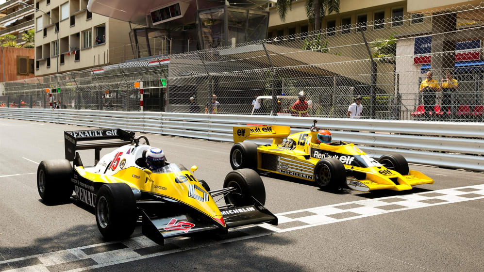

Renault did a demo with '78 and '83 cars too:
Note the low profile front tyres on the '78 car for people who think low profile tyres are a merely an unfortunate modern phenomena. They were allowed 15" fronts until the early 80's and many of the designers made use of that for the advantages of the bigger wheels and lower profile tyres. :wink:
