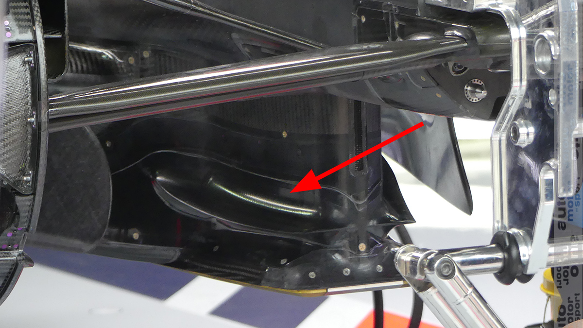

New thinner splitter with AM winglets
@tgruener

Pictures from Australia
1567
Re: Red Bull RB18
IMO one of the reasons the RB underbody has that step (red) is because RB pushed their tub quite far rearwards to free a little bit of space for the tunnel mouths...
The tub's position impacts the shape and size of the tunnel entries and coke bottle

Or ....it generates local flow distrubance to cancel porpoising .... at max speed, once the floor start to close to the track, the stepped areas generate flow disturbance and "reduce" ground effect
:?: :-k
