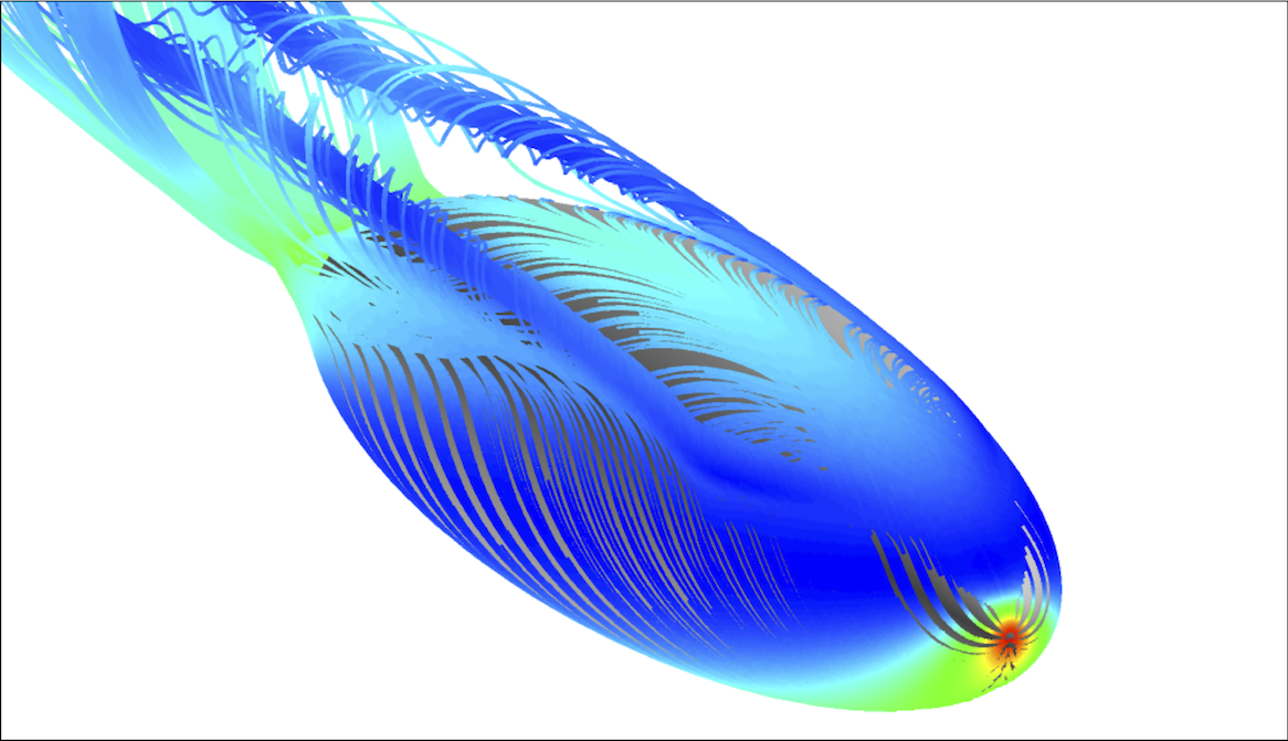

The Red Bull has the widest central section, and like the Ferrari, the central section is egg shaped.
I imagine the flow is doing something like this alongside the floor, when looked at from underneath. If you wanted to start those vortices earlier, then it makes sense to put a pair of VG's before the body generated ones.
