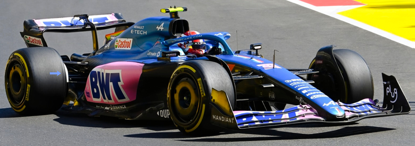

Small RW + big BW vs Big RW + small BW
https://pbs.twimg.com/media/FVshxirXsAE ... ame=medium
Nice comparison.
Interesting to me is if you factor in the beam wings, it would seem that the “overall rear wing angle” (for lack of a better term, meaning if you were to combine the angle/area of the rear wing and beam wing) between the two cars is roughly similar. Alpine seems to prefer to tune the beam wing more drastically while running a relatively smaller rear wing compared to the field. I wonder why that is? My guess is that they see a drag benefit but nobody else seems to follow this line of thinking.

Blackout wrote:
21 Jun 2022, 15:12
Do you think running higher AoA beam wing has any effect on cooling? They've really shrunk the rear opening since winter testing.

Re: Alpine A522
peewon wrote:
22 Jun 2022, 00:57
Blackout wrote:
21 Jun 2022, 15:12
Good question. I dunno. I guess the high AOA beam wing, and the new top beam wing, will upwash that airflow better towards the low pressure zone that is below the RW, and that should improve that hot air extraction...
That rear opening will definitely help the beam wing IMO, thanks to its small size indeed. It's probably the smallest outlet amongst the non-louvered/little-louvered cars : )

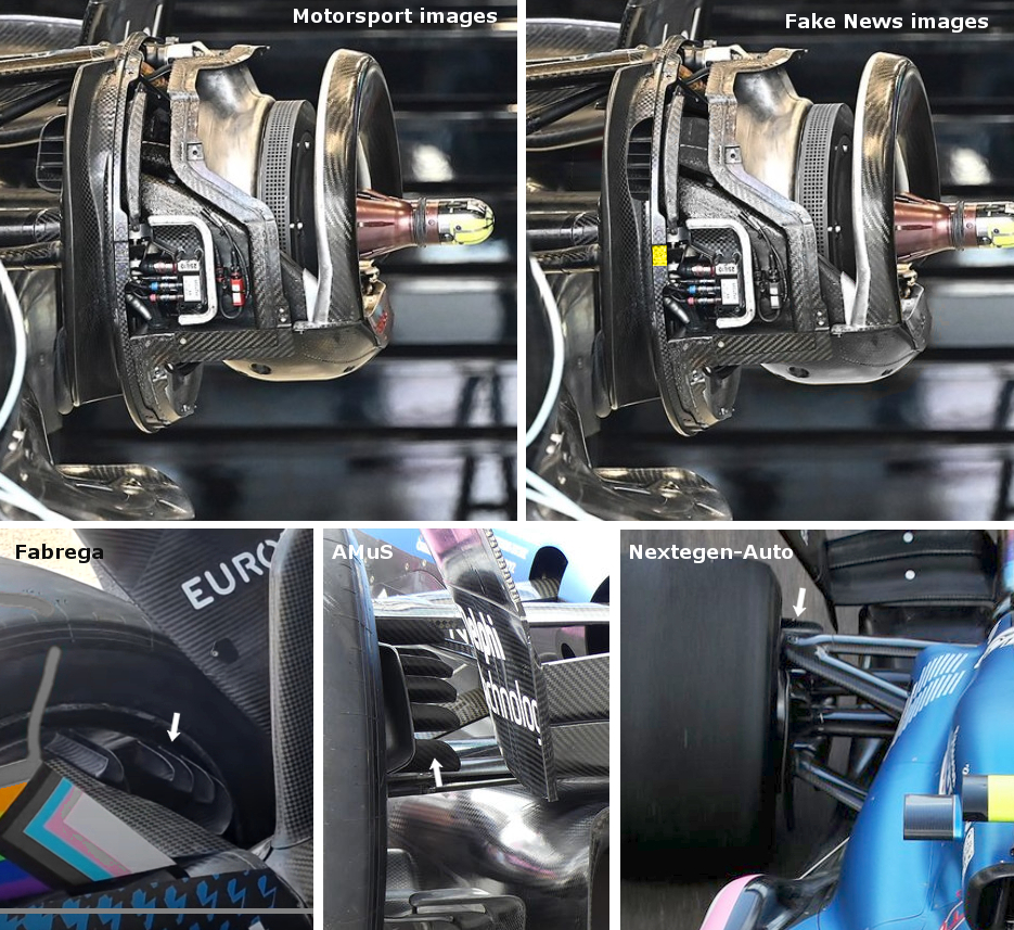

diffuser wrote:
13 Jun 2022, 21:31
Think Blackout is slacking ...
Alpine tested something else in FP1, inside the gap between the wheel and its deflector (blue)
Interestingly, Alpine seems to be the only team that only uses an air scoop for the rear brakes cooling, while the others either only use an inlet in the gap, or scoop + gap (Alfa, RB)
My Guess would be extra cooling for braking in Montreal.
The fairing looks the same in Canada
That white stuff is probably foam to see how much the tire deforms on track...
Maybe they'll alter that wheel deflector later to make the whole assembly more streamlined
Or maybe they will open a cooling inlet in that blanc space and fully/partly remove the scope, which should bring more air to the wheel winglets
Or maybe they were just testing tire deformation

Re: Alpine A522
I think the white foam is an "inlet packer". or "blocker" if that makes sense.

Re: Alpine A522
22 Jun 2022, 16:22
What does it do?
1563
Re: Alpine A522
There is no inlet there anyway, except maybe that tiny channel (yellow) that might channel some air to those electronic elements. (the blue scope inlet seemingly cools the caliper while the red ones cool the disc)
