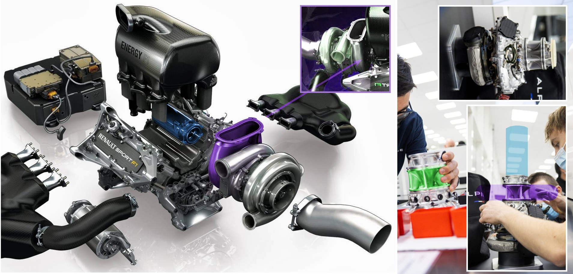

Gotta jump in here for clarification.. Renault have never really had a split turbo (as we know it) previous to this year (in the sense we are referring to) The biggest hurdle to climb is having the entire rotating assembly balanced across the length of the block without it detonating itself regularly (see Honda 2017). Their old layout would of hampered compressor size having it in the valley as well. And I was fairly sure the turbo was combined and the H unit was in the V (see pic).
Renault through the years when asked about splitting the compressor were publicly outspoken of the design thinking there was no advantage... And in typical fashion for them, they end up actually doing it but keeping it hush as to avoid embarrassment. Ferrari did the same thing, thinking it had zero benefit until this year it seems and while the '22 PU isn't identical to the Merc/Honda layout it is 80% there, they have split the turbo but have done something a little more unique on the compressor side.
