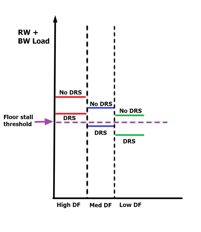

and people [even recently] don't understand why on high-downforce tracks the advantage disappears."
My guess is the high downforce wings (beam wing and rear wing) likely are not able to shed enough of the low pressure at the back of the car when DRS is opened, to enable the floor to stall. With the medium and low downforce wings, there's less low pressure at the back of the car, meaning that the actuation of the DRS flap passes over the critical point after which the floor begins to stall.
This is a simplified depiction of that model and why the advantage goes away in high downforce trim. Assume you have a high, medium, and low downforce package. The DRS in the high downforce package is not able to reduce the DF coming from the beam wing and the rear wing sufficiently enough to cause the floor to stall.
Ferrari seems to have imitated this to a certain extent. They can miss between 1-5km/h from track to track with their various rear downforce configurations but we saw in Spa that the Ferrari was only missing about 1-2km/h in DRS on-off comparisons.

IIRC RB ran a low BW with high DF RW at Mexico in 2022 so that might be an interesting data point @AR3
383
10 Aug 2023, 18:18
I could be more thorough eventually, but I did a quick skim through f1-tempo. Rb was gaining +27kmh w/ the DRS in Mexico City last year compared to +23 km/h for the Mercedes in it's high downforce trim.
In the '23 Hungarian GP high downforce trims, RB gained only +15km/h and Mercedes also gained +15km/h from DRS. As Hamilton pointed out, the advantage really didn't exist at all that weekend.
There is a potentially outlying factor in that the lower air density in Mexico. 25% less air density translates to 25% less downforce from the same wings. This factor in addition to the low-load beam wing for Mexico could have pushed the load (and pressure) at the back of the car down into the range where DRS was capable of causing the floor to stall.
Just a theory. It would make sense with the way that Wache has been describing the effectiveness of their DRS, saying it's linked to the floor and why it wouldn't work in the max downforce rear setting.
