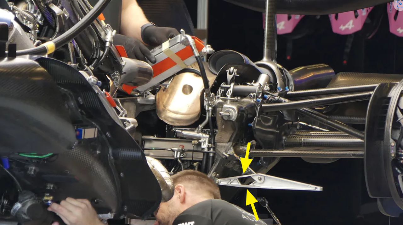

Very exposed rear-end from AMuS - is this the first we see of these internal metal struts from Alpine (that presumably support the floor)? @Blackout :D We've seen similar feature on RB18/RB19 and Mercedes W14

Interesting pocket...

If I may speculate...
Either it's as simple as an opening to route cables or hoses, or it is designed to be the intended point of failure.
I could imagine that if the floor would bottom out, and the force would exceed what the stucture/parts/floor can handle, the metal gaff would buckle there, ensuring no damage to the gearbox (as gearboxes are limited) or to save the floor from cracking.
The design of the gaff is very simple. A fully weight optimised solution would likely look different. Simple designs are easy to predict, so buckling forces can be quite accurately designed in.
