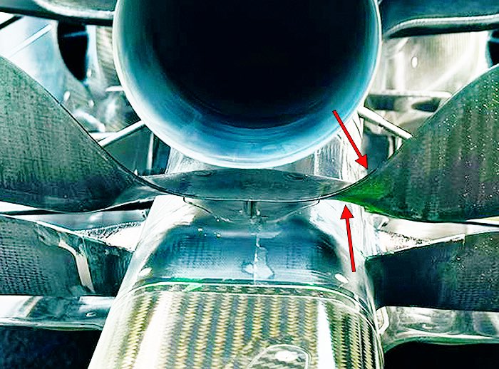

Some new sculpting of surface at the outlet just ahead of rear suspension. Maybe intending to introduce some upwash to prevent losses spilling downwards as much
https://i.imgur.com/PVWq5dH.jpeg
Are you referring to the "dent" to the right of the outlet?

20 Jul 2024, 10:17
Looks more like introducing local curvature on both top and bottom side (as much as possible) to form a diffusing surface to aid with hot air extraction. Lovely details

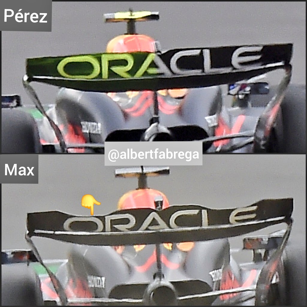

Re: Red Bull RB20
New rear flap for FP2 at Spa. Less drag when DRS is closed.
