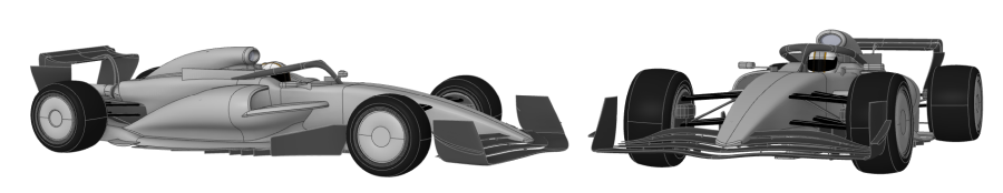

I just sent this car to Monza, not even the time to paint it.
More pictures in the next days (official MVRC Page on LinkedIn).
