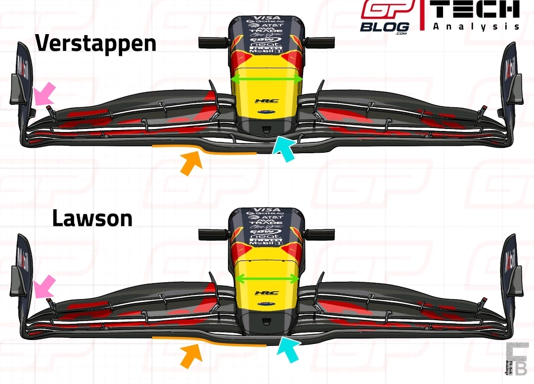

Lawson has the old parts (maybe gave him more confidence)

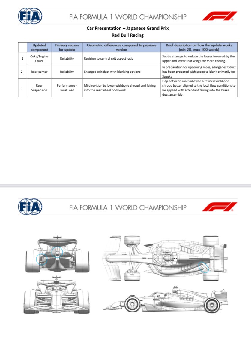

Upgrades for Japanese GP

are these rear brake cake tins new?

The rear brake tin looks 3D printed. Those parts were made in a hurry.
Different material for less or more heat transfer? GP told Max to try a different "test cycle on braking" so they are looking at either getting rears upto temperature or not overheat.
