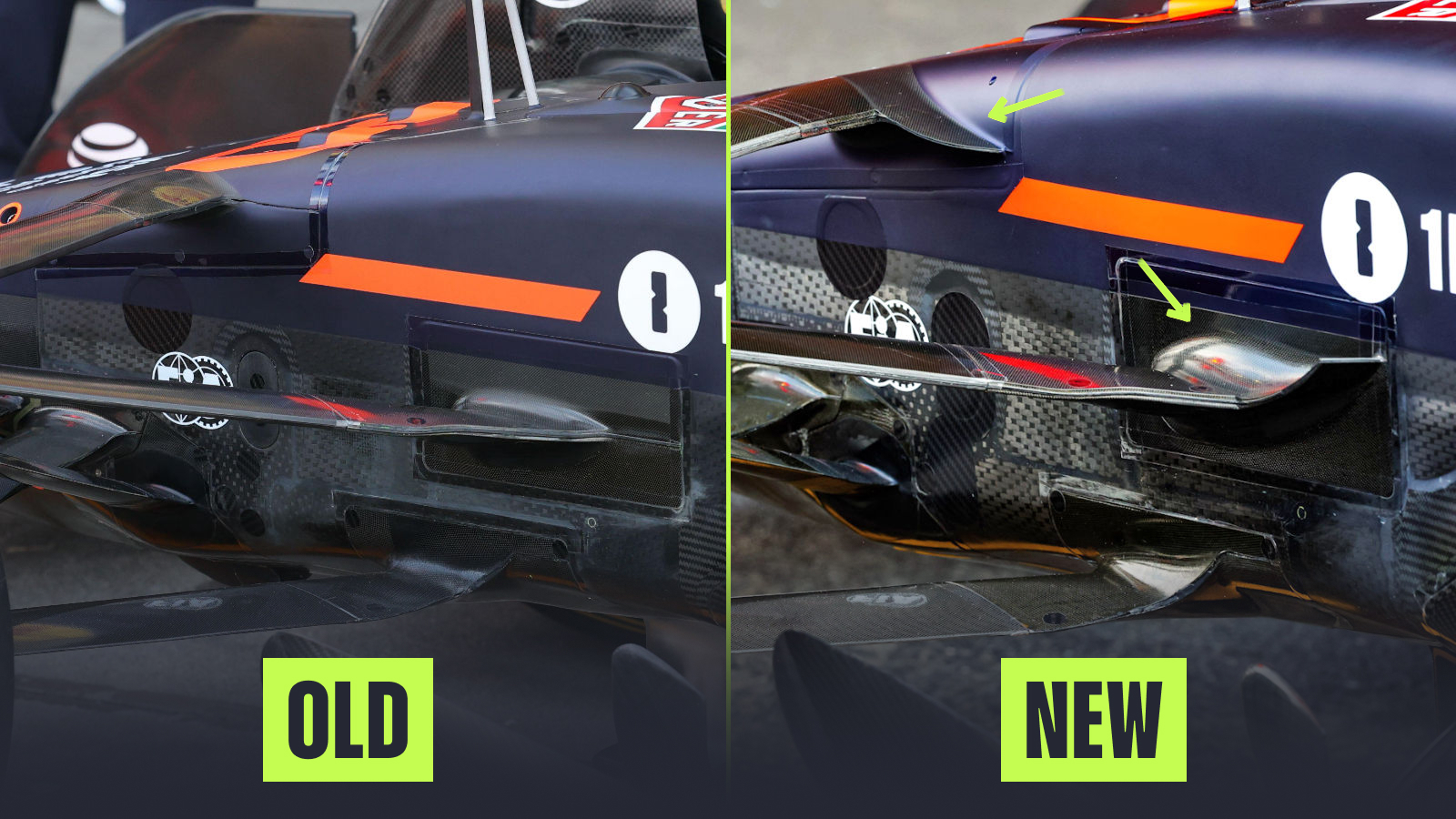

Changes to the RB21:

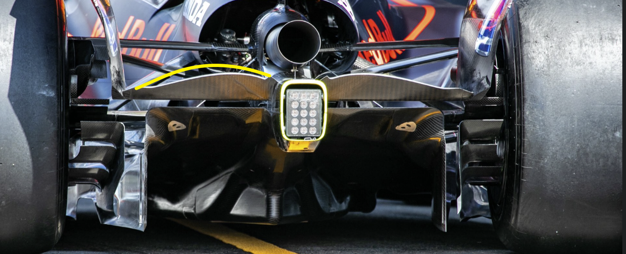

Very nice view on the rear end of the RB21:

lio007 wrote:
26 Jul 2025, 10:01
The cannon shape is new, more of a half-circle, different from the pure obround, horizontal slot shapes they've used the past several seasons.
Also, the spikes on the beam wing--are they new? I don't see them on any other iteration this season.

vorticism wrote:
27 Jul 2025, 17:33
They definitely had something like that earlier in the season, I don't remember which race though. It was another similar low downforce setup.
607
Re: Red Bull RB21
They are not spikes. It's a cutout in the trailing edge of the full chord beam wing as a makeshift way to cut drag and/or adjust the aero balance.

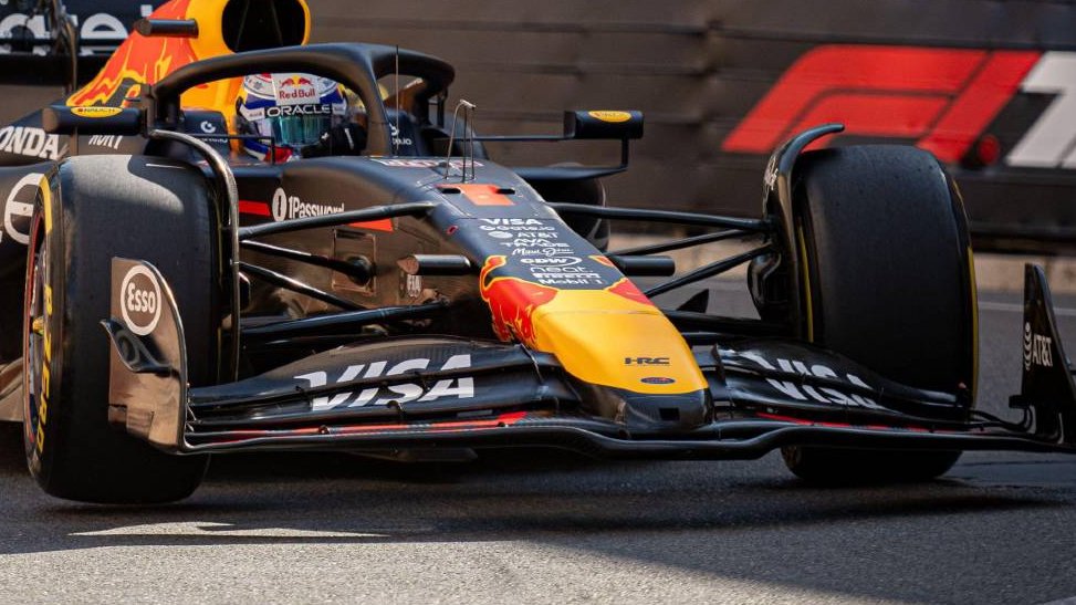

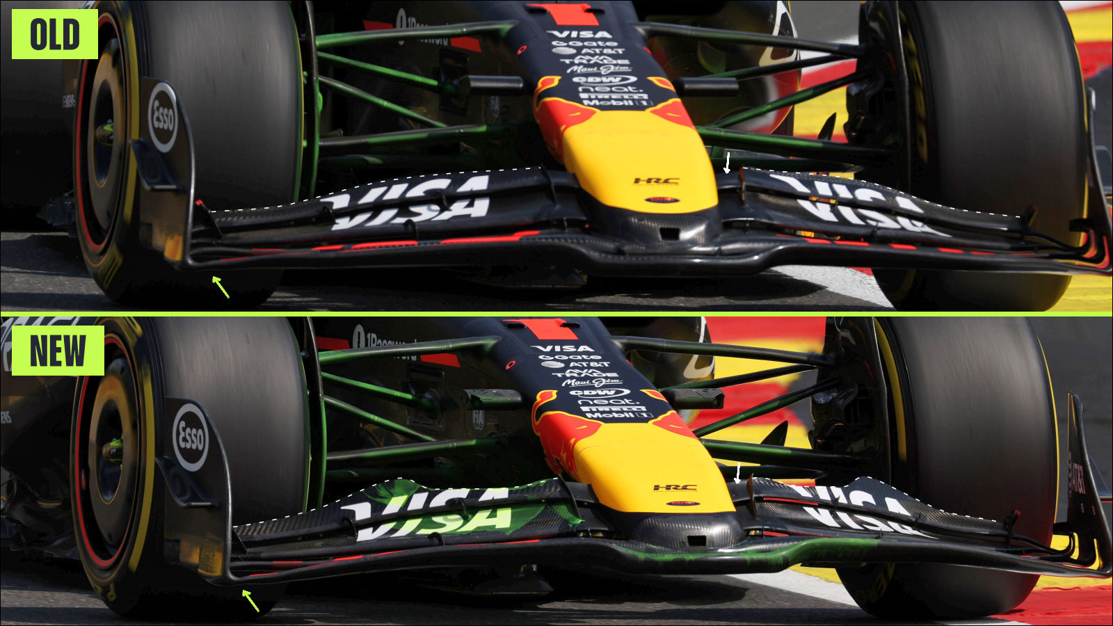

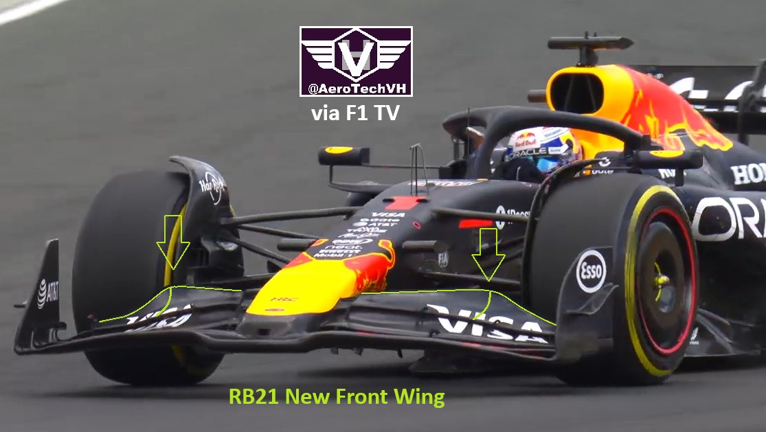

New Front Wing on RB21: The spec introduced here is for high-load tracks and will probably be used in Zandvoort, Singapore, Austin and Mexico, maybe even Brazil if found useful enough. Highly cambered on the outside, Red Bull seem to try to keep smaller upwash along the nose where the air is affecting the floor inlet
It's very different load distribution across the span compared to previous high-load spec seen in Monaco, which features a moderate upwash mid-span
Old:
basti313
basti313
32
Joined: 22 Feb 2014, 14:49
Re: Red Bull RB21
The perspectives are a bit difficult to compare....did they use the same wing in Spa, just trimmed on the upper plate? I think the curvature above the "SA" from VISA looks very similar.
