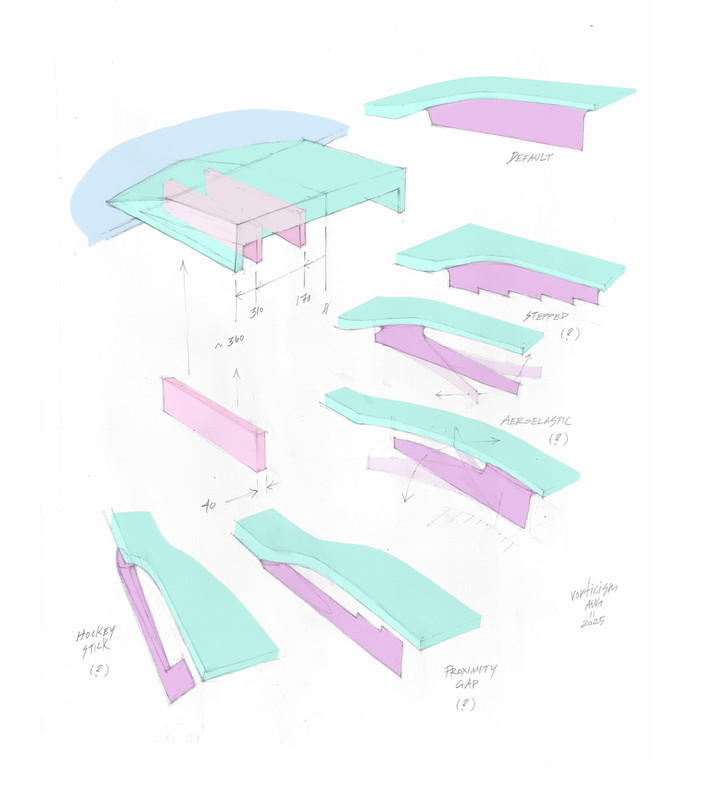

A few more areas of interest:
--Sidepods: The sidepod volume overlaps the leading edge of the floor volume. It might be tempting to use the sidepod component body as an extension of the floor, although with concessions to the shaping limits of the sidepod (section & radius limits). It would be unorthodox to locate the lower edge of the sidepod so close to the leading edge of the floor, a treatment not seen since before 2009, so it may be a bad idea. The main advantage I see here would be in powering the FLEDs with a vertically oriented airstream.
--Cooling ducts & legality box boundaries: there may be scope for using the legality box boundaries and the wording of the cooling duct rules to supply clever inlets that do not rely upon the sanctioned sidepod apertures. For example, the cooling ducts are largely unregulated; their main limitation seems to be that they must not be visible "from outside the car" from any view perpendicular to the longitudinal axis, so a duct which faces inward between a gap in the engine cover and the "mid chassis" (safety cell/monocoque) could be hidden by the floor and the engine cover.
--Tunnels: there seems to be scope to create a tunnel through the outboard extremities of the engine cover, between the floor and the engine cover, with concessions to the engine cover shaping rules which demand soft surfaces everywhere (min and max radii), meaning the inlets and outlets of such a tunnel would be somewhat compromised. The engine cover component bodywork* can have up to two sections in a z plane and only one section in x planes, but crucially there’s no limit to the number of aerodynamic surface sections it can have upon that initial component bodywork x plane section. Thus the single x section rule for this component bodywork could be satisfied while having two aero surface sections upon that same single section.
--Sidepods: they might be totally omittable. The side impact structures can fit entirely within the engine cover volume. One of the two mirror stays can only attach to a sidepod surface, the other must attach to the safety cell/cockpit body. So if you can get away with one mirror mount and boundary interface cooling inlets, you should be able to omit the sidepod surfaces entirely. Worth noting, the sidepod volume is relatively small.
You could say all of these are legal, but not necessarily advantageous.
*The various areas of the car are now dealt with as “components” which are evaluated individually with cross-section limits, and the surfaces of these components which do not join to other components are called “aerodynamic surfaces” because they would be the only part of that component exposed to the airstream.
Approximation of the relevant reference volumes:
High res: https://x.com/athalkunni/status/1949527890510659684

Updated with images: https://www.f1technical.net/forum/viewt ... 1#p1298371
vorticism wrote:
27 Jul 2025, 19:58
Holm86
252
Joined: 10 Feb 2010, 03:37
Re: 2026 Aerodynamic & Chassis Regulations
vorticism wrote:
27 Jul 2025, 19:58
https://i.postimg.cc/Vshxt4m1/FLExs.jpg
https://i.postimg.cc/wTsSQJjN/hiddeninlet.jpg
https://i.postimg.cc/JzVS6ns2/tunnel.jpg
https://i.postimg.cc/Sx63wh8N/sidepodvolumes.jpg
Interesting idea's, and great sketches. Would be fun to see them realised in 3D, and run through CFD

Holm86 wrote:
06 Aug 2025, 19:59
Interesting ideas, and great sketches. Would be fun to see them realised in 3D, and run through CFD
Gonna assume you don’t mean Colorful Freehand Drawings... :-k although I could add more arrows and squiggly lines. Simulating a simulation may or may not yield useful data...
A while ago Newey had mentioned in an interview that this ruleset still had room for innovation, or something to that effect. Which seemed unbelievable considering the restrictiveness of the current rules. I couldn’t tell if he was just trying to be optimistic for his new employer. So I gave the aero & chassis rules a look and found what might be the areas he was referring to. Take them as general concepts, not optimized. They may be of no benefit-- working within the laws of the FIA is a different matter from working within the laws of physics and mother nature.

dren wrote:
08 Aug 2025, 16:07
Love the drawings. You've looked at these aero regs much closer than I have at first glance. Is there any wiggle room on the diffuser kick location to move it as far forward as possible or is it pretty set in stone?
Seems like a ~150 mm window to locate the diffuser neck fore/aft. The diffuser area is about 800mm long (it's part of the “Main Floor” box, a single complex box which contains the diffuser, flat floor, leading edge ramp, and barge board foot; the word ‘diffuser’ is not mentioned in these regs). Most of the floor area box, the center expanse, is ~20 mm thick. The diffuser box height is ~160 mm and slopes gradually, terminating into the flat floor. Rough numbers but it paints the picture: the neck can’t be all the way in the middle of the car, nor can it be all the way back at the rear axle. What stands out to me is the roof of the diffuser box, which is half of its height. The intent is probably to accommodate a large corner fillet but might permit variation within the limits of the "Main Floor" box (single x, single y, <2 z sections, R 25mm min surface curvature except within 5 mm of the top view edge boundary).
Furthermore the "fences" (what others might call a strake or vane) should provide some differentiation. One per side within the diffuser, straight, variable left-right placement. 1 x, 2 y, and 1 z section. A variety of simplistic forms should still be feasible. Not depicted by me yet here, but it could also permit forms similar to the current edge wings, rotated 90*.

A couple of weeks ago the FIA released issue 13 (i.e. revision 13) of these regulations. It adds an allowance for a t-tray shock absorber fairing (C3.5.13 d). Apparently the keel area can be pushed back (more topside t-tray exposed) and the strut/shock-absorber can be faired. Which raises questions for this and for regulatory revisions in general:
-Why choose a blunter keel profile with an exposed strut vs. the more familiar pointy, long keel (the keel, floor, FLED interaction is surely a primary focus)
-Did a team or teams suggest this to the FIA?
-Did the FIA decide this independently? (e.g. is their research group currently active with CFD/wind tunnels?)
-Is there a ratification process for revisions?
-How much interaction is there between the FIA and teams w.r.t. rule writing, etc.
-Is six months ahead of testing unusually late for regs revisions?
In June the FIA released issue 12, which added "Floor Corner," a square section directly in front of the rear tyre. It permits familiar pre-2022 floor edge winglets. A region of relative complexity (for these regs). 3 x, 4 y, 2 z sections. Qvist on x/twitter has a good illustration of his interpretation of it. Talk around F1 often include concerns about dev costs and complexity. Yet, the FIA added this complexity region 8 months ahead of testing.
So far I've addressed the areas that I think will provide the most visual differentiation for bystanders. The front and rear wing regs seem watertight, as they are currently. There weren't any big surprises on that front from '22-25 apart from Aston's '22 RW endplates. If anyone's brave enough they could f.e. look for loopholes within the seven (yes, seven) pages which define the shape of the FW...
