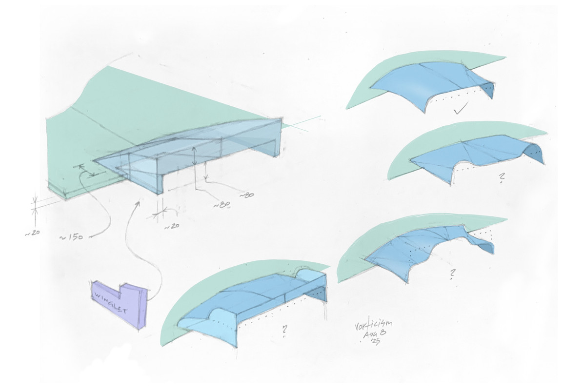

Love the drawings. You've looked at these aero regs much closer than I have at first glance. Is there any wiggle room on the diffuser kick location to move it as far forward as possible or is it pretty set in stone?

vorticism
vorticism
340
Joined: 01 Mar 2022, 20:20
Re: 2026 Aerodynamic & Chassis Regulations
dren wrote:
08 Aug 2025, 16:07
Seems like a ~150 mm window to locate the diffuser neck fore/aft. The diffuser area is about 800mm long (it's part of the “Main Floor” box, a single complex box which contains the diffuser, flat floor, leading edge ramp, and barge board foot; the word ‘diffuser’ is not mentioned in these regs). Most of the floor area box, the center expanse, is ~20 mm thick. The diffuser box height is ~160 mm and slopes gradually, terminating into the flat floor. Rough numbers but it paints the picture: the neck can’t be all the way in the middle of the car, nor can it be all the way back at the rear axle. What stands out to me is the roof of the diffuser box, which is half of its height. The intent is probably to accommodate a large corner fillet but might permit variation within the limits of the "Main Floor" box (single x, single y, <2 z sections, R 25mm min surface curvature except within 5 mm of the top view edge boundary).
