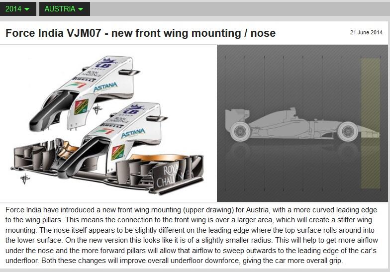

Yes it was. The duct used to be for an oil cooler but I couldn't see it during the test.Mamba wrote:Was that aero package tested during the test week? Where is the new turbo cooling intake located if they removed it with the new update? Looks good and fast though...
MAMBA
The air will be directed around the outside of the wheel. This in turn pulls away dirty wheel wake from the floor which will also improve airflow further down.monsi wrote:This feels like such a dumb question, but I really don't know the answer. There are wing elements that are clearly designed to move the air outwards, from well inside the line of the wheels. Why would you try to move the air out of a fairly clear pathway past the suspension into the blockage area of the wheels ?
