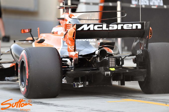

Perhaps I'm missing something, but since when does introducing higher pressure into an area of lower pressure(because that's how a wing works) increase downforce?

Re: McLaren MCL32 Honda
Compared to the black MP4-31 WOJ the slots on the end-fences don't run up all the way to the main and DRS plane. New one seems to interfere less with the low pressure pocket directly underneath. Old one probably caused some issues bleeding off DF.

wesley123 wrote:
22 Apr 2017, 21:32
Ah! I just posted something related above... They do it slightly further down. Reducing drag and possibly helping to energize flow over the diffuser.
*edit
The slots at the leading edge of the floor seem to work in a similar way; adding energy to (or rather reducing the energy loss of) the vortices' that seals the side of the floor.
