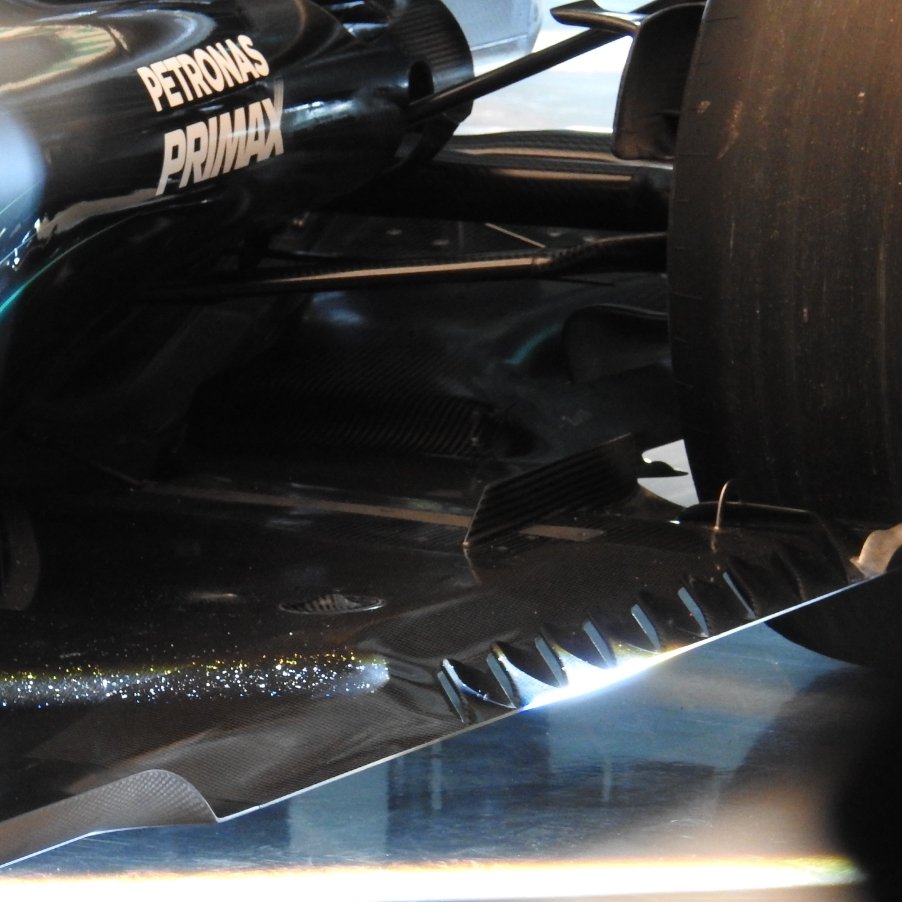

Any ideas what this is? Or is just light playing trics on me?

That's the inside of the step plane transitioning to the diffuser entry.
There's a little metallic supporting arm similar to front wing componentry, for the tire slot (green arrow).

One of the slots in front of the rear wheel is connected to each other. Wouldn't that make it illegal, as the hole now is fully closed?
PReviously teams got around the no holes rule, by adding a small opening at the outboard edge, making it a cut out instead of a hole. With the connector it does create a hole

There's a tiny T-wing tucked away under the radiator outlets.

Might reside outside that specific legality box e.g. under the curvature of the tire face.

Is that the start of the shroud/lower rear suspension arm around the drive shaft?
No, follow the highlight contours of the diffuser bulge. This twitter thread shows examples of similar devices:

Are those cuts in the floor new?
Maybe that`s their answer to Ferrari`s & Red Bull`s having practically another rear wing in front of the side-pods air intakes ... Hope these floor cuts are in the same vertical plane of car`s CoG in order to further increase mid and also overall car`s DF ...

dren wrote:
23 Feb 2018, 13:26
"enhance..."
https://image.ibb.co/d2i0Vx/DWq0_G8_VWAAECng1.jpg
Oh, it's not a winglet. It's a connector holding up the floor! Looks like the gearbox entirely floats above the floor now and to top it flexing they have to attach the two with a connector.
