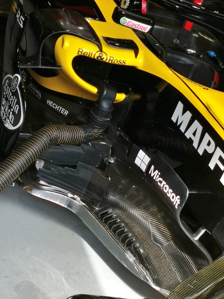

This is certainly an important area and here is the 2017 version.

That area of barge boards seems to be very important. Interestingly, it was Ferrari's 2017 development direction that most teams chose to include in 2018 car concepts, with two (though Ferrari now have 3) pieces of airfoil-shaped vortex generators. Even though they don't look like conventional VGs, they seem to be doing the same thing as their outboard floor cousins (Ferrari literally had the same shape early in 2017, that piece that was seen to be flapping and needed to be reinforced).
They make a pressure difference on top and bottom side (being airfoil shaped) and since some of the air near the trailing edge has a lateral velocity component (i.e. it's going along the trailing edge) it causes a spin. The series of small flaps at the very tip of barge boards induce the initial vortex, while this second one induces another. Since most teams chose to remove a piece of bodywork between them, I have a feeling they want to separate these two vortices.
Mercedes, it should be said, mentioned that this area (those 2 new pieces they added for 2018, the ones we are talking about of course) is very important for overall floor sealing, especially for their higher rake this year. Since all 3 top cars now have the same shape in that area, it makes perfect sense. Also, the floor is obviously sealed even there, not only on its sides. Which is amazing for diffuser performance.

Vanja #66 wrote:
29 May 2018, 22:06
=D>
Right on the money. This is why this car was so fast. They knew and they've focused on this area over the winter.
Raked cars especially benefit from this as it's in line with the floor, it's the most ground effect wing on the car. Also, riddle me this, what are the deflection limits on that part of the floor? The possibilities are endless, but first step would be for McLaren to ditch that vertical plate, and add more chicken wing, and rely on vortex generators upstream to guide airflow instead of that plate.
