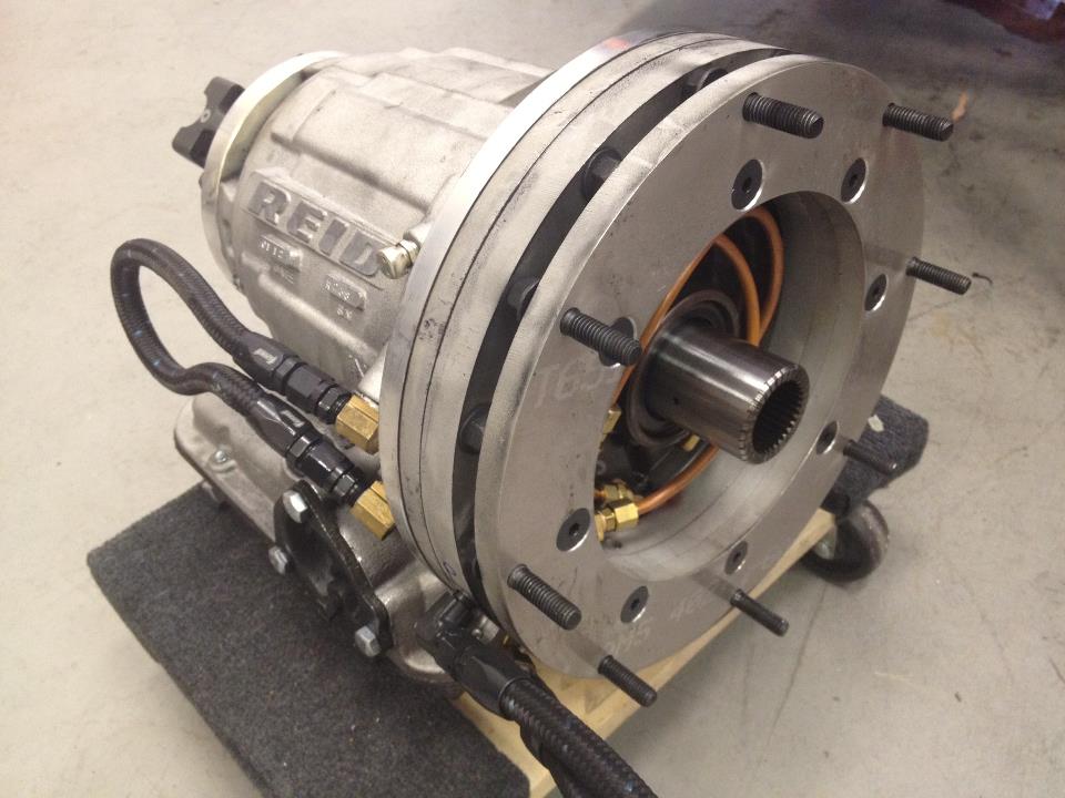

Cool. Makes a wankel look big. Look like they took it to Pikes Peak:
The motor's hooked up to a Powerglide automatic sans torque converter. 8)
