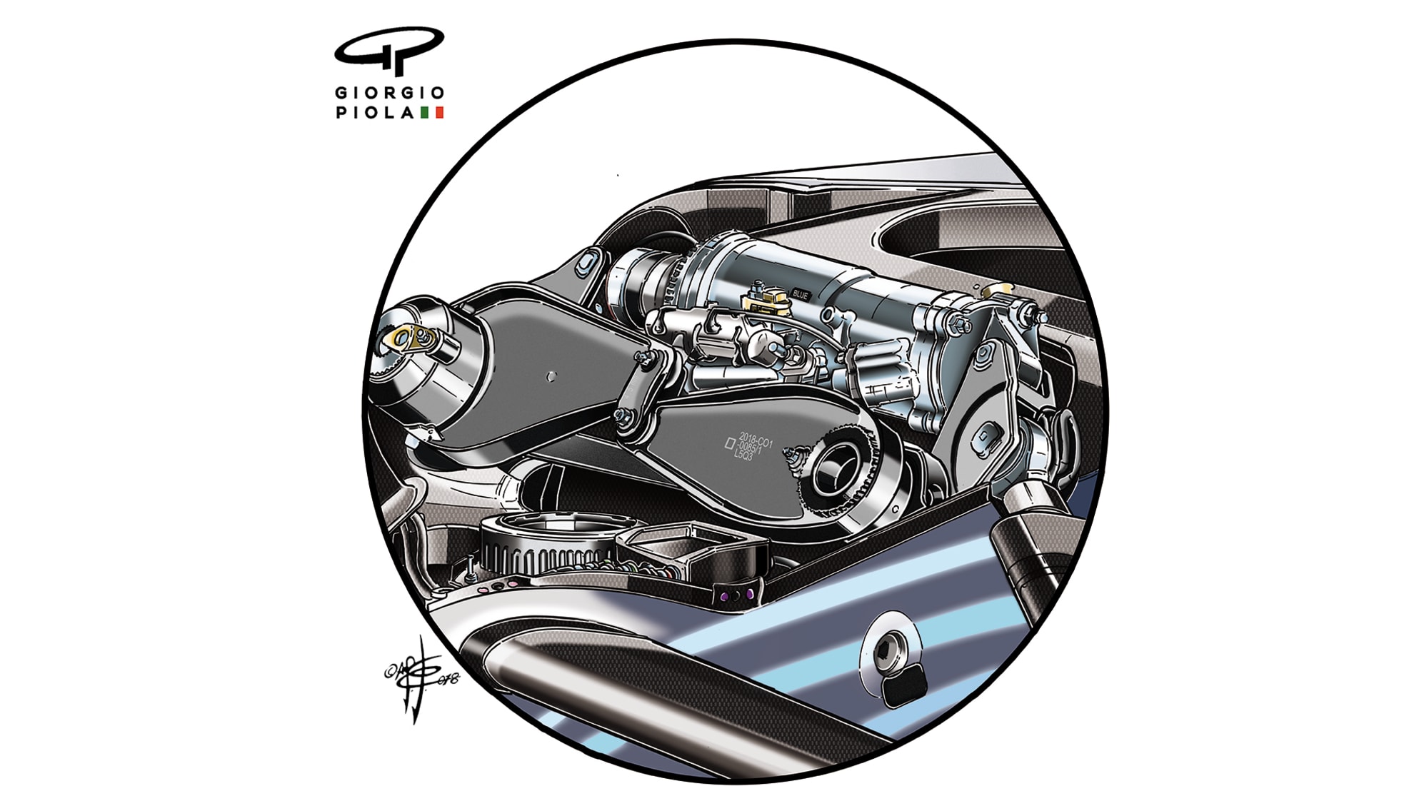

Merc's old setup was hydraulically actuated. It looked like this:
It wouldn’t make much sense to revert, considering the rule changes coming up in ‘21.
Looks pretty similar to the end of ‘19 setup to me.

"However, one non-aero part that did appear on the Mercedes in both Singapore and Sochi was new – and is almost certainly related to the expected ban on hydraulic suspensions for 2021. The new component was a different version of the front suspension heave spring.
The heave spring on an F1 car controls the vertical stiffness of the suspension. On the Mercedes of the last few years, the spring rate was hydraulically-controlled. Internal valves would determine the rate of flow from one chamber to another and thereby control the stiffness. But, following the example of Red Bull, the spring rate of the new component is determined by Belleville washers. These are cone-shaped springs and are often used in preference to conventional coil springs because they are much easier to package."
https://www.formula1.com/en/latest/arti ... Nkwyq.html
Also discussed here:
https://finance.yahoo.com/news/gary-and ... 39677.html
https://www.formula1.com/content/dam/fo ... /image.jpg
I do not think they are washers, maybe the F1 website got it all wrong; as they do sometimes. Washers will take compression and have spring behavior, but when it comes to rebound i do not think the spring rate will be existent if the force on the element is outside of the pre-load on the washers (as the washers wont exhibit spring behavior if they lose pre-load and aren't in contact). Using washers is very limited then in terms of the displacement of that heave element to maintain the preload. From what i see, those springs are machined springs and not washers. Look on the big gaps between it.
I could be wrong though if there is further evidence suggesting that the element is made of washers.
