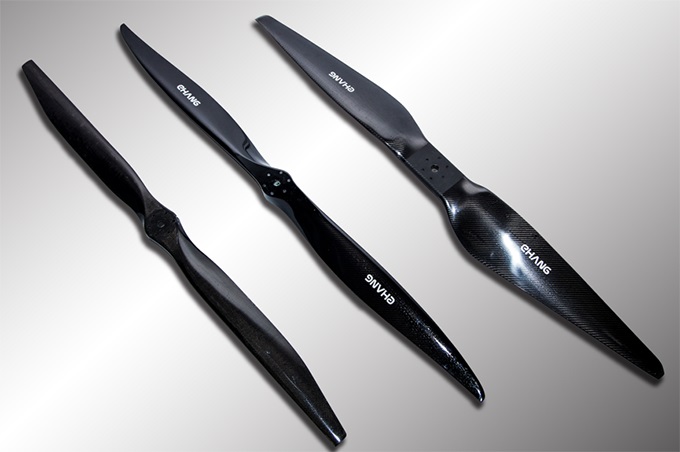

Tommy Cookers
621
Joined: 17 Feb 2012, 16:55
yes they are available
https://www.kitplanes.com/propeller-buyers-guide/
the DUC Swirl may be the sort of concept I had in mind
the Aeromatic seems to have been in the 1940s a passive system as other recent posters here have suggested
anyway novel active systems (for low-powered engines) now seem to be available
some even in hub-only form suitable for customers to source their blades
and ground-adjustable pitch is the feature now very widely offered (for home-built aircraft)
I assume this to be setting the prop pitch 'in the workshop' to match the application
btw
if 15" 6.5 degree pitch means geometric pitch (ie installed angle) .... is this enough ?
even in hover won't the airstream velocity reduce the effective AoA far below 6.5 deg ?

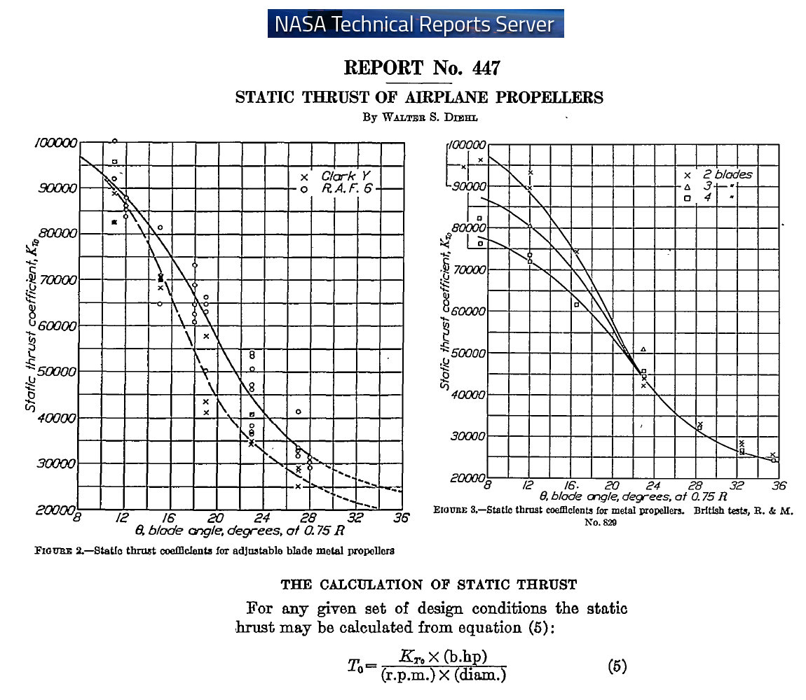

manolis
107
Joined: 18 Mar 2014, 10:00
Hello Tommy Cookers.
You write:
“if 15" 6.5 degree pitch means geometric pitch (ie installed angle) .... is this enough ?
even in hover won't the airstream velocity reduce the effective AoA far below 6.5 deg ?”
The complete pdf document is at https://ntrs.nasa.gov/archive/nasa/casi ... 091521.pdf :
The formula at the bottom of the image says that the static thrust is directly proportional to the power and is inversely proportional to the revs (in other words, the static thrust is directly proportional to the torque applied to the propeller).
The static thrust coefficient increases substantially at smaller “geometrical” blade angles.
Case 1:
With 8 degrees blade angle (at 0.75R), a 43” diameter propeller has:
Atan( tan(8) * 0.75 ) = 6 degrees blade angle at 1.0R,
which gives a propeller pitch of: tan(6)*43”*pi=14”
Case 2:
With 20 degrees blade angle (at 0.75R), the same propeller has:
Atan( tan(20) * 0.75 ) = 15 degrees blade angle at 1.0R,
which gives a propeller pitch of: tan(15)*43”*pi=37”
The static thrust coefficient halves in the second case (Figure 2).
The formula says that for the same static thrust and the same revs (rpm), the 43” propeller will consume in the second case (37”pitch) two times the power it consumes in the first case (14” pitch).
The formula also says that applying the same torque to the propeller, the static thrust halves in the second case (37”pitch) as compared to the first case (14”pitch).
I think the previous reply to your question.

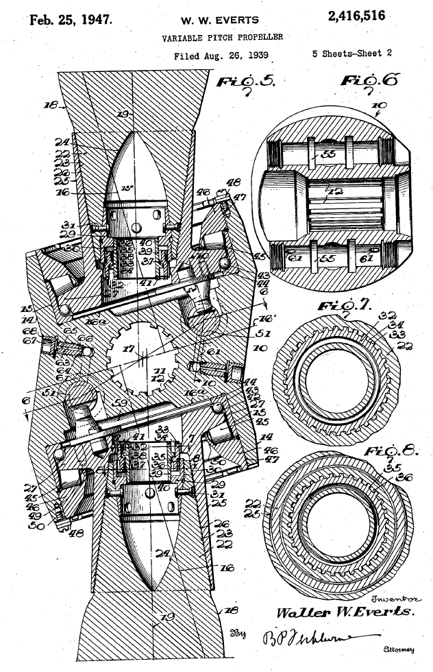

You also write:
“the Aeromatic seems to have been in the 1940s a passive system as other recent posters here have suggested”
At https://www.pattakon.com/Pitch/US_2134661_Aeromatic.pdf and at https://www.pattakon.com/Pitch/US_2416516_Aeromatic.pdf there are two US patents granted for the Aeromatic propellers:
The Aeromatic design seems too heavy (count the number of heavy bearings required) and too complicated for the Portable Flyer.

Tommy Cookers
621
Tommy Cookers wrote:
21 May 2020, 10:15
yes ok MP I now agree that pitch is enough
(the Diehl paper seems valuable in that regard)
enough particularly as a tailslide would be more problematic to a prop with a greater geometric pitch
(as the reversal of incoming air vector could increase the aerodynamic pitch eg beyond the 'stalling angle')

Compare the “mechanism” of the Aeromatic propellers with the “mechanism” (?) of the PatPitch propeller, their weight, space requirement, cost etc...
And think the advantages the PatPitch propellers can bring to Flying Devices like the Ehang 841 (here are the proppellers they used, the older design at left, the last design at right):
the air taxis in general, the drones (big and small ones), etc, etc.
Thanks
Manolis Pattakos
