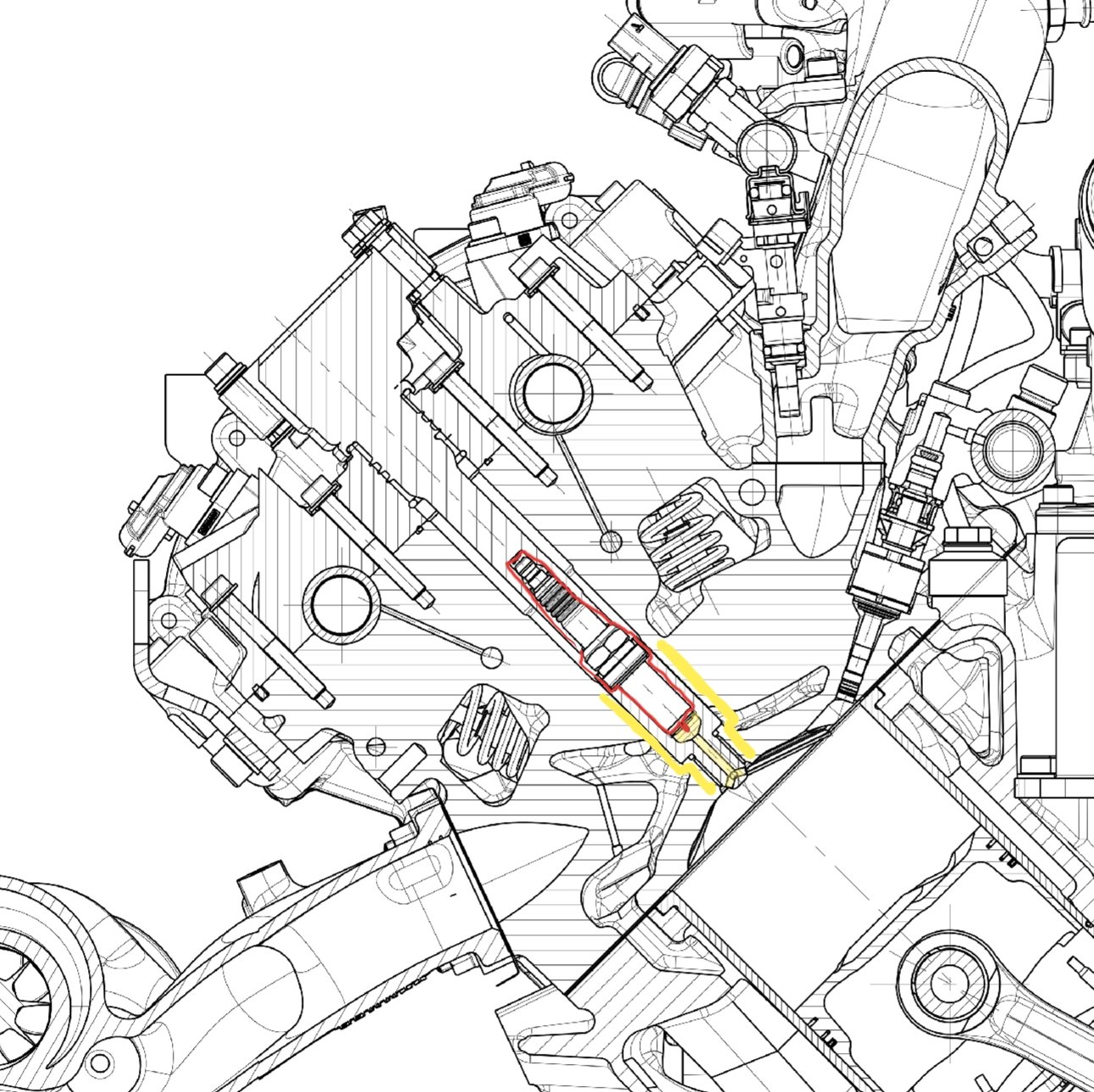

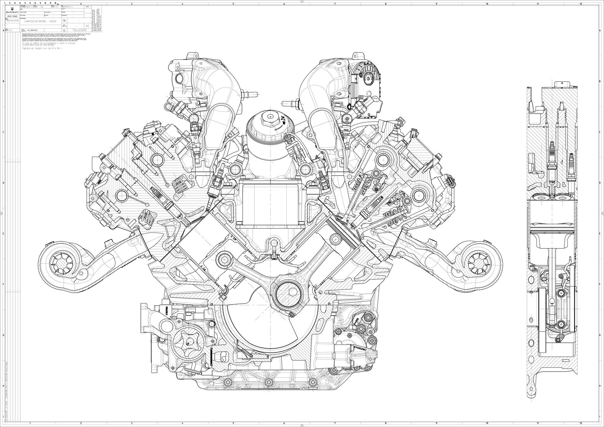

It does look like an F1-compliant prechamber (different from the original Mahle TJI which had both the injector and the sparkplug in the prechamber) with added port injection and second spark plug, presumably for low load/idling.
Also, since I was advocating the advantages of steel liners over parent aluminium bores here's a couple nice cross sections courtesy of ScarbsF1:

Some more detail in this video. https://www.youtube.com/watch?v=to50KsCAjUM
Also shows a second spark plug in the main chamber for "other" operating modes.Why they didn't opt for the superior control and flexibility of injector in pre-chamber I am not sure. Royalties to Mahle?

Passive pre-chamber. Basically an old-school spark plug sleeve.. but claims of stability.
