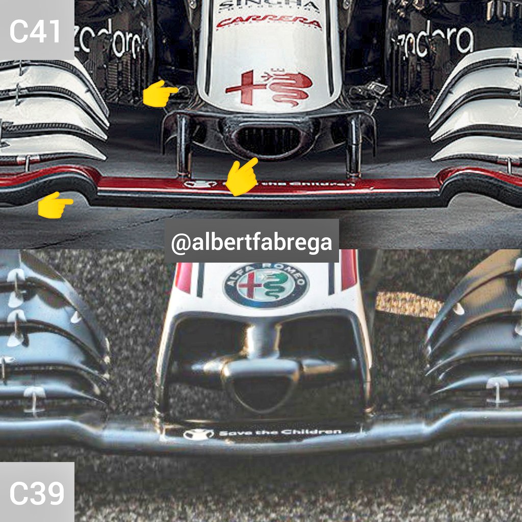

Thinner nose this year- indicative of something we may expect to see from the Ferrari works team?
no, i wouldnt think so, if anything it means that they're expecting the engine not to be super powerful. Because the narrow nose works best at lower speeds, whilst the large nose works best at high speeds, and is usually prone to stalling at lower speeds...
That's a ridiculous line of logic.... How much would an - in F1 terms - "weak" engine offset the operating window of a car within it's aero efficiency curve? Will it significantly lower top speed/approach velocity to high speed corners? Will horsepower deficiency on it's own make a car worse in low-medium speed turns? I don't think so...

Holm86 wrote:
22 Feb 2021, 13:57
Nose is quite unique, looks like the cape is starting already from the tip
Via @AuRupteur
Holm86
250
Joined: 10 Feb 2010, 03:37
Re: Alfa Romeo C41
Morteza wrote:
22 Feb 2021, 14:00
Holm86 wrote:
22 Feb 2021, 13:57
https://pbs.twimg.com/media/Eu0-X_5XYAI ... name=small
https://pbs.twimg.com/media/Eu09k0xXIAI ... ame=medium
Via @AuRupteur
Very interesting design

Nose looks really interesting! Also curious about the positioning and aggressiveness of the front wing main plain curves. Car looks very neat and quirky, very Sauber.
1088
Re: Alfa Romeo C41
The nose reminds me of Mclaren circa 2018 (i think).
Good looking car.

The nose has some cat-fish whiskers that obviously generate vortex.
I'm very surprised that we haven't seen more of that if it was legal?🤔
And if using Ferrari 2020 rear suspension, are they able to update pieces/dampers so it doesn't get "squishy" at temperature?

Zynerji wrote:
22 Feb 2021, 14:09
My bet is, it could be because its more draggy than previous concepts, but creates a more powerful vortex.
This might have been a better trade off this year, to seal the diffuser with the new floor.

Mansell89 wrote:
22 Feb 2021, 13:31
Alfa don't follow Ferrari aero concepts and vice versa, they're totally different cars. If it was Haas maybe but even then, why would Ferrari copy one of its customers like that? It happens the other way around

You'd have to think Tokens well spent in this case, especially when you look at the amount of detailing on the front nose; Nice job Sauber Romeo. :P
I'm quietly confident for these guys this year; I still reckon a big part of their lack of pace last year was down to the engine and having to compromise the car setup as a result of it... so if they (like Ferrari and Haas) have more power at their disposal, then I reckon they're in with a good chance at joining the mid-field battle proper.

HungarianRacer wrote:
22 Feb 2021, 14:00
stan_french wrote:
22 Feb 2021, 13:34
Mansell89 wrote:
22 Feb 2021, 13:31
There's a great little thing from reddit i highly recommend you read, i think it shed's more light in my line of thinking:
https://www.reddit.com/r/F1Technical/co ... ame=iossmf
But basically it explains that a car's aero development can be limited by the engine to a certain degree. especially when the aero is made for ever increasing horsepower. And notably the larger nose is said to help cars in higher speed, however it is also more prone to stalling at lower speeds than the narrower nose. What I'm trying to say is that i think the reason they went down the narrow nose path was because they do not have anymore the Ferrari horsepower advantage which greatly helped their nose concept in accelerating the air to the bargeboard. So in order to better suit the car to the engine, they decided to focus on something which the slightly underpowered engine could better help with, which is with the narrower nose, and thus helping their car work better at slightly slower speeds, and reducing the proneness of the nose to stalling.
