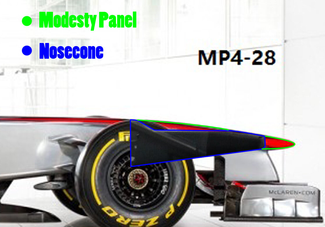

To clear things up!
This is McLaren's nosecone and modesty panel:
And this is my take on Scarbs' suggestion:
EDIT: I know this will sound cocky but when i saw the photo from inside the cockpit looking over the survival cell and i said that the mp4-28 would definitely have a high nose and people attacked me saying how could i possibly know from that photo....i have been drawing cars for quite a while now so my eye is 'trained'...

Re: McLaren MP4-28
That's off. The top blue line should be a level surface.
The top surface of that "leaked" nose cone will be at 90 degrees to the mounting points on the nose.

Diesel wrote:That's off. The top blue line should be a level surface.
It is a level surface...its as level as it gets...
the car is raked...so it is at 90 degrees to the mounting points on the survival cell
Re: McLaren MP4-28
Nice work amouzouris. it confirms my suspitions that mclaren constructed their chassis in such a way that they still can raise the height of the nose.

I have to wonder... Is the bulge travelling all the way across the nose there because they're channeling air around inside the nose, or is it just structural. Moving air around somehow like that could explain why McLaren don't want it shown.

beelsebob wrote:I have to wonder... Is the bulge travelling all the way across the nose there because they're channeling air around inside the nose, or is it just structural. Moving air around somehow like that could explain why McLaren don't want it shown.
The bulge on the side, nearly level with the step? if so, it looks like a reflection to me, the photo have been taken through glass.

Only took roughly 8 hours for a reflections to come to the McLaren car thread :P
If you follow the lines you should see that it's just a reflection on the glass.
