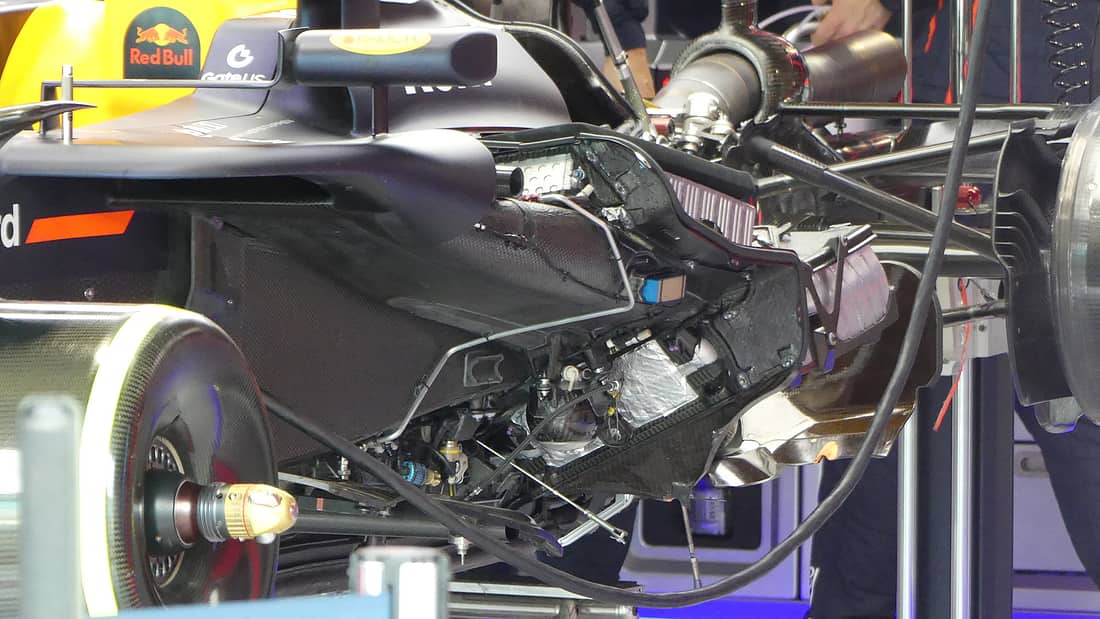

Is this the only car with this strange internal layout for the radiators?
Yes!

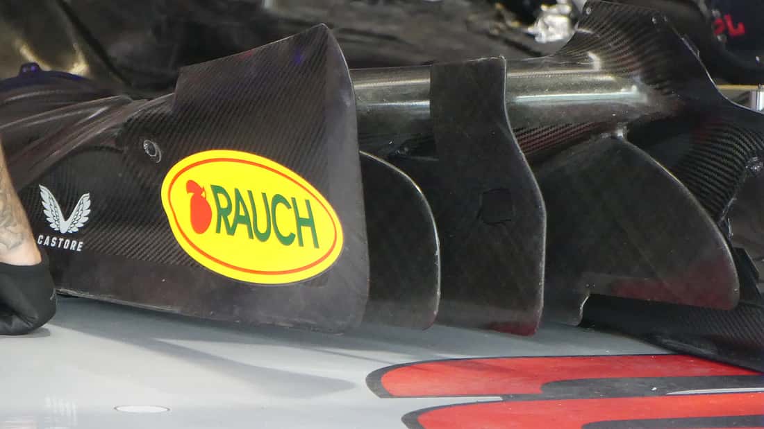

Fabrega has made a mistake here. The bottom picture is the rb21 launch spec, same edge wing used on day 1 and 2 of pre-season testing rather than the one that was used at races 1-4. But it's understandable how he made the mistake as on Thursday at Saudi Arabia red bull used the old/testing spec floor during pitstop practice, so when he went to find a comparison photo for the new floor edge wing he went to his camera roll from Saudi Arabia.
On further inspection it looks like strangely red bull actually raced with the launch spec rb21 floor rather than the upgraded floor used at rounds 1-4 brought during testing ... Slightly concerning
Testing day 1/2 (launch spec)
Testing (new spec)
Australia (new spec)
Japan (new spec)
Bahrain (new spec)
Saudi Arabia (Thursday / where fabrega got his photo)
Saudi race (launch spec)
Marko said at Saudi that the trackside team would have a new approach using their engineering knowledge rather than trusting the simulations. So perhaps switching to the old spec floor was part of that

Compared with RB21 pre-saudi, it looks the same in SP cooling config
https://i.imgur.com/nSpgxJT.png
Old spec floor fences for comparison - looks like same spec currently fitted to car in Miami
https://i.imgur.com/fgbbSAV.png
Either they’ve found enough internal aero performance and correlation stability with the current setup that a more aggressive repackaging step isn’t needed... Or, they’re choosing to evolve the internals gradually, resolving local flow issues and validating each step before going further. This would reduce risk and allow better calibration between simulator, CFD, and on track behavior. We don't know if it's still on the road map to be introduced later or not.
We also shouldn’t rule out the possibility that some of the correlation issues were addressed by other means, like simulator algorithm adjustments, better trackside instrumentation, or floor sensitivity tuning rather than just by mechanical repackaging.

Nicolas Carpentiers highlights the innermost floor fence as possibly updates for Miami. The change looks like it's less rounded off to meImage
This angle by Motorsport displays the new shape more clearly
Miami
This Motorsport shot also gives us a good angle on the new floor edge wing. Personally I can't see any difference between this and the one run at Bahrain, china, Australia and Japan (see my previous post for comparison shots to previous FEW)
https://i.imgur.com/jwzQLAH.jpeg
Testing (new spec)
https://i.imgur.com/f3CT6SP.jpeg
https://i.imgur.com/hFevo4O.jpeg
Japan (new spec)
https://i.imgur.com/rjSVjzs.jpeg
Bahrain (new spec)
https://i.imgur.com/MYpT6Z5.jpeg
https://i.imgur.com/XnmUsrM.jpeg
https://i.imgur.com/YsszV4L.jpeg
Is the bahrain final spec one that is simply having a more straightened out floor edge? I can't see significant differences. Same with the new one lol.

I think I am getting more sold on this whole layout theory by SilentStorm. At Miami, the RB19 gains through the T11 to T16 section both in qualifying and in race relative to the RB21 (actually a really solid 3 tenths). Strangely enough this explanation here would explain much of that I think. The RB21 is generally better in high speed but loses a lot more when there's a lot more direction change needed in low speed. Rear tire management could be something that Red Bull need to work on but maybe this internal layout change might be something we might see have a pronounced effect at Imola.
