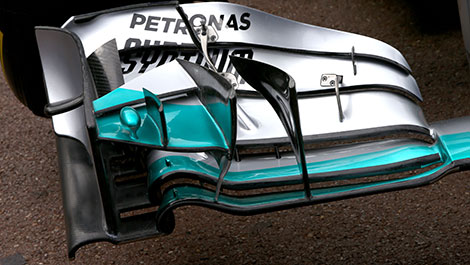

Not talking about the end plates, good Sir. I was speaking of the front upper flaps. If you look on the Mclaren, Mercedes, Lotus and Force India the front upper flaps and the inboard vertical turning vane are shaped to work together to side-wash the air going over the outboard, upper shoulders of the tyre. This is not something that was commonly done before. Only Lotus did this concept in 2012 until about 2013 when other teams adopted the concept. Ferrari's upper front wing flaps are only midly turned outward and seem to not redirect the air outward as much.
2012 Lotus Front wing
2014 Mercedes front wing
I think Ferrari's upper wing flaps are quite old in design; intricate wing flaps have never been a priority for Ferrari. I think that needs to change with this formula. Ferrari needs to adopt the newer concept as any advantage is welcomed at this point. I won't be surprised if they introduced a new wing with the Vertical turning vane and aggressively turned upper flaps in a few races. (Silverstone?)

I think Ferrari's solution is actually better.
Mercedes' aggressive outwash design appears to be an attempt to provide more consistent downforce at the expense of peak downforce. The flaps direct more air flow around the high pressure area in front of the wheels, but the effective span of the wing is compromised in order to accommodate the sharper bend.
The more subtle bend of the Ferrari design, on the other hand, allows for a longer span, because it relies more on the steering angle of the wheels to direct air flow around them. That means there will tend to be a bigger variance between peak downforce created in turns, where it's needed most and where drag is relatively inconsequential, and downforce created along straights, where it's largely unneeded and induced drag is a penalty. That makes it more efficient.
However, the dependence on that complex interaction between the wing and the wheels also makes it difficult to get right. Ferrari has been working on it since 2012. But, I suspect there's a good reason why Red Bull, the undisputed Kings of Aero, have copied (and probably perfected) this concept.
As always, of course, I could be completely wrong, though.
