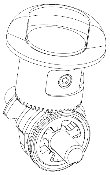

Hello all.
PatCVT
In the PatCVT a sprocket or gearwheel (actually an idler) is intermeshed with "teeth" on both spans of the V-belt.
The displacement of the center of the sprocket varies positively the transmission ratio:
enabling various "modes" of operation:
Drive Mode:
The lever that holds the sprocket is released to pivot freely about the cross; the CVT runs automatically under the control of a variator in the one conical pulley and of a spring / torque cam in the other conical pulley.
Sport Mode:
Performance oriented.
A control spring pushes the lever towards the conical pulley with the spring / torque cam; the CVT continues to run "fully automatic", but it selects shorter transmission ratios.
Economy Mode:
For green, quiet, reliable, comfortable operation.
The control spring pushes the lever towards the variator's conical pulley; the CVT continues to run "fully automatic" (as in the "Drive Mode"), but it selects longer transmission ratios.
Manual Mode:
The rider / driver displaces "manually" the lever about the cross to select any transmission ratio from the available infinity, regardless of what the "variator / spring / torque cam" command.
By locking the lever at a number of discrete positions, the CVT replicates a manual gear box.
In all modes the sprocket acts as a "baffle roller" (drive belt tensioner), too.
The available space inside the CVT of many scooters (like, for instance, the Sport-City Aprilia 250cc, below) is more than what the PatCVT needs:
How it works?
With the sprocket engaged with the toothed-V-belt as in the animation, the sprocket divides the V-belt in two parts (one at left of the sprocket and another at right of the sprocket), with each part maintaining its length constant.
The move away of the center of the sprocket from the one conical pulley causes the decrease of the effective diameter the V-belt is running on this conical pulley, and the increase of the effective diameter the V-belt is running on the other conical pulley.
For more: http://www.pattakon.com/pattakonPatCVT.htm
Thoughts?
Thanks
Manolis Pattakos

Hello Tommy Cookers.
You write:
“in the PatCVT the controlling belt has loads passing through its teeth via the pulley teeth ? (the belt teeth you have said before are not intended for loads)
because the belt load path on the other side of the control point is 'length-compliant' (not rigid as in the PatBox)”
In the PatCVT there is no “controlling belt”.
There is only one belt, the V-belt, that has teeth at its inner side.
The controller is the sprocket intermeshed with teeth on both spans of the V-belt.
Regarding the efficiency:
Take a scooter CVT, like, say, the SprotCity Aprilia 250cc of the photo, modified to PatCVT.
If you release the lever that holds the controlling sprocket, the bearing of the sprocket runs, more or less, unloaded; the teeth of the sprocket remain unloaded, too.
The sprocket acts as the original “baffle” roller.
The efficiency of the CVT is as without the PatCVT.
Now suppose that at some conditions you prefer a 15% shorter, or longer, transmission ratio than the ratio the CVT selects normally at these conditions.
The bearing of the sprocket and its teeth are far from being overloaded, because the sprocket has to apply to the V-belt only the difference of the force required for the specific transmission ratio, and because the efficiency of a toothed sprocket cooperating with a toothed belt is quite high (above 99%; worth to note: there is only one sprocket).
For instance, suppose a force of 20Kp (44lb) is applied on the center of the sprocket towards the one conical pulley; this force changes by 10Kp (22lb) the force acting on each span of the V-belt; and due to the wedge action of the conical pulley, this force (the 20Kp / 44lb) is multiplied by 4 to give the additional axial force resulting on the moving half of each conical pulley.
So, with 20Kp loading the roller bearing of the sprocket, and 10Kp force from the sprocket on each span of the V-belt, the axial force on the movable halve of each conical pulleys change by 80Kp (176 lb).
If something of the previous is confusing, please let me know to further explain.

The prototype works as the theory predicts.
However, the important is the theory, the theoretical solution proposed; not the working prototype.
Please do read, at the page 107, post #1601 of this thread, what the professor Rui Chen of the famous Loughborough University - UK did (“Quasi-constant volume spark ignition combustion”, presentation in the International Engine Expo 2009, Stuttgart Germany) in order to achieve the longer piston dwell of the OPRE and PatOP engines.
So, if you still don’t like to comment on the PatATE idea because the “make one and show us” requirement is not yet fulfilled,
you can alternatively write your technical objections / thoughts about the PatOP.
Thanks
Manolis Pattakos

Muniix wrote:
22 Aug 2017, 04:57
The crankshaft rotating assembly in the PATop design has excessive bearing friction and inertial forces due to having bigger big end diameter than main journals.
You don't need to perform a bearing friction model simulation to realise this.
You have excessive mass in the bigends meaning the smaller mains are under greater loads than they need be. Flexing the crankshaft more than it need to.
This is just bad engineering, what goal is this design trying to achieve, technical analysis only arrives at short man syndrome.
When someone does identify an issue it's never acknowledged or worse the classic deflection, straw man response follows. With the identified issue ignored and the original claim repeated all over the interwebs, confirming the analysis is correct, SMS.
Muniix, sometimes you demonstrate a high level of understanding of engine technology but you repeatedly cancel such moments with one-eyed posts like this.
- Bearing friction? Seriously? Take a look at the OPOC.http://thekneeslider.com/ecomotors-team ... oc-engine/
Do you have any idea of the contribution of crankshaft bearing friction to engine losses? 100% increase in big end bearing friction would make a tiny difference - easy to justify if there are significant gains elsewhere.
- Main bearing loading? Seriously? The Pat OP has zero loading of the the main bearings - from combustion forces and inertial forces. They all cancel.

I did say specifically the PATio engine, one with the one piece rods, larger bigends than mains.
gruntguru wrote:
23 Aug 2017, 01:28
Muniix wrote:
22 Aug 2017, 04:57
