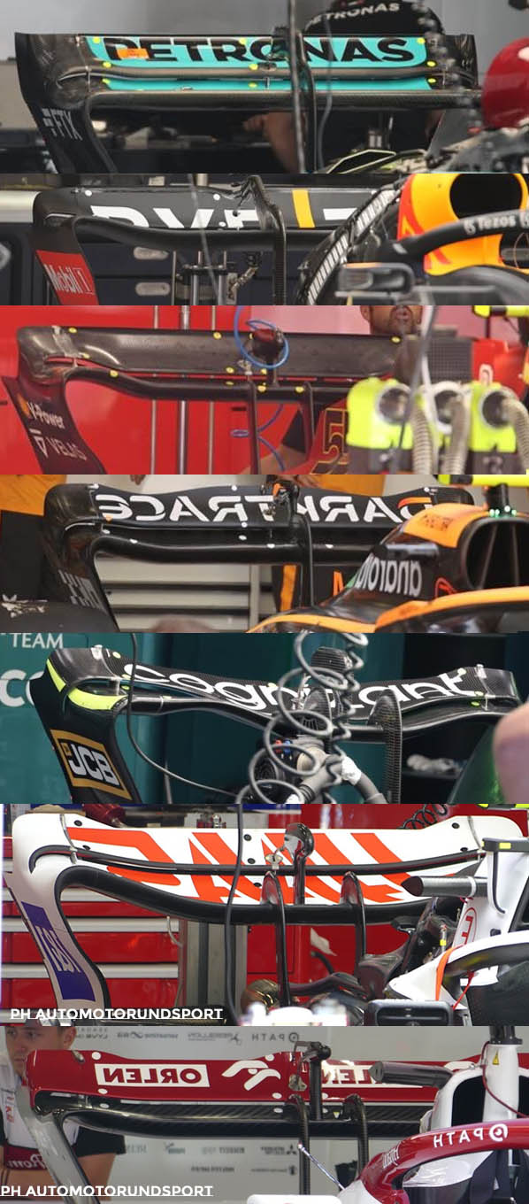

This is the wings in Baku, reposting here as the post got buried in the race thread.
How i got the scaling:
I marked the hinges and center of the wings and scaled them all to the same width to the best of my abilities (source images were low res) - with the assumption that Fabrega took all those images from a similar distance whilst standing (same camera height) this should allow a somewhat accurate comparison with the Mercedes wing as baseline for the copypasted reference lines.
Here's the full image i worked in without the new Ferrari wing.
This one includes the new Ferrari RW and the old one.
