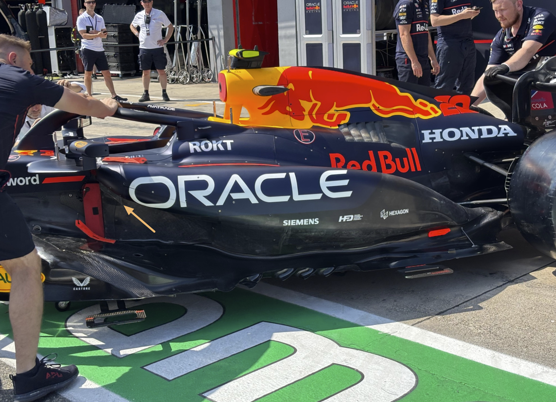

Strake doesn't continue. Seems like a hard stop due to a regulations box.

Some teams use a strake as the mirror mount on top of the sidepod. Maybe this fits in the same legality box.

Matt2725 wrote:
15 May 2025, 16:00
Someone will know, but which legality box allows for that strake to be under the sidepod?
It's the same that allows turning vanes to be on top. They cannot be extended rearward however as that would be outside the side pod inlet box.
Mercedes exploited this with previous cars but on top.
I have not read the GE regs, but normally there is a minimum radius rule for sidepod and engine cover area, that pretty much makes it impossible to have thin geometry on the sidepods like creases and fins.
If not for this rule the water slides would have sharper edges for stronger vortex formation.
