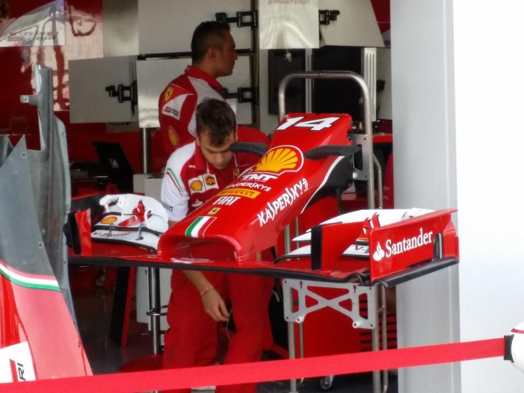

Cascade-less front wing option for Ferrari at Monza. Image credit: ScarbsF1.
