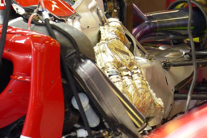

Exhaust's heat protection (not new) (Amus)
