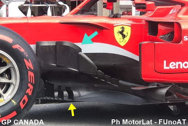

New hotness from Ferrari. Seems to have worked for them, looks like everyone is developing this area now.

Old setup with crappy paint CFD.
As you can see Ferrari has added slots near the edge of the bargeboard over the mid wing, precisely to preserve the vortecies that are travelling both over and laterally across the mid wing.
