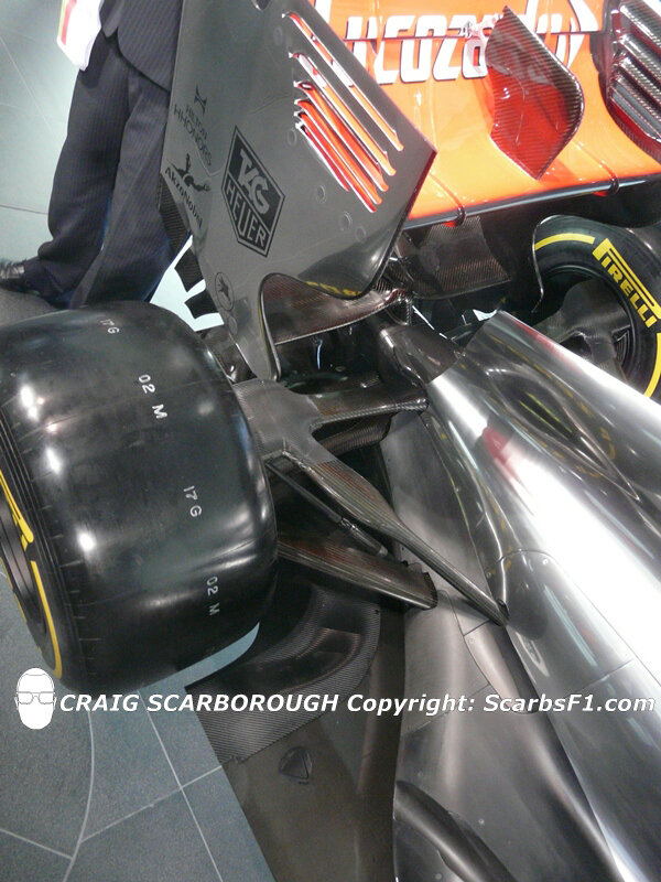

#McLarenMP428 Detail: The rear suspension is again pullrod and follows Redbull by enclosing the driveshaft

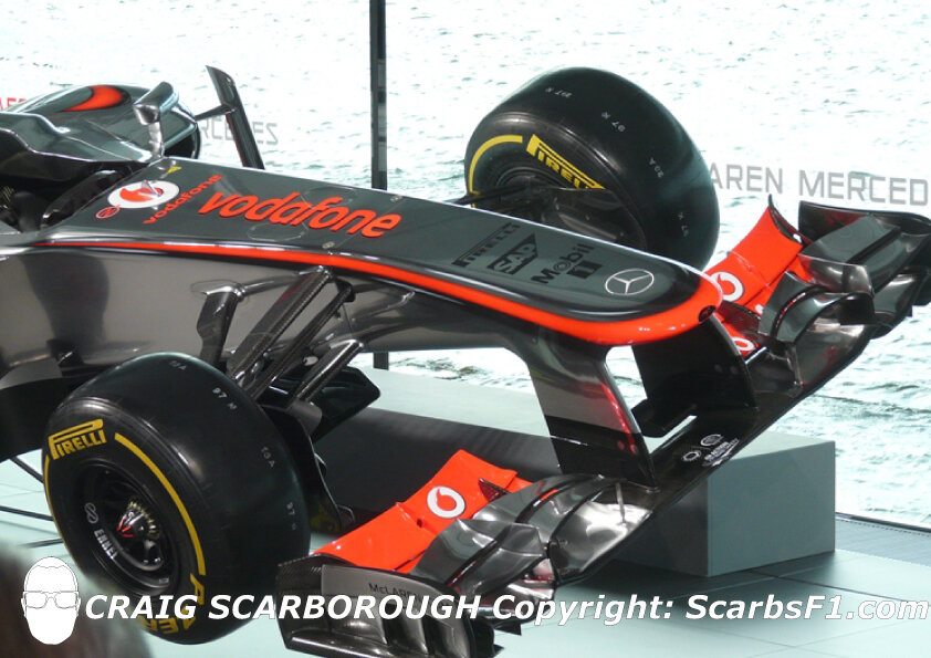

#McLarenMP428 Detail: The frotn of the chassis is raised to 625mm and the nose step is disguised under a modesty panel

It is most certainly a modesty panel. The nose would else be too high. It is intricite to mclaren to work on aesthetics, so they refined it that much that it seemlessly integrates in the bodywork.

Based on stefan_'s last photo it looks like they have repositioned the front brake callipers to 6 O'Clock so that can put a mini diffuser close to the ground on the inside of the front tyres. I expect this gives them more downforce (and less drag) than the "traditional" tri-plane wing higher up. Of course these bits are small but they all add up.
Anyone have a shot of the rear brake ducting to see if they are doing the same thing there?

Craig Scarborough ‏@ScarbsF1
So i was right :D

I noticed anchor points underneath the nose. Turnings vanes are to follow. Strange that for a presentation car with such a level of detail, it isn't showing the turning vanes. What could mclaren possibly be hiding?

Same as Renault, they obviously think their is an advantage to be had through parts that are easy to copy in the front wing and turning vane area. I would guess, new front wing and turning vanes, new floor and diffuser to come and maybe the hoop vanes around the sidepods again!

ringo wrote:Doesn't look like there's a modestly panel to me. Just looks like the nose.
And thereby stating the exact reason for a modesty panel! I think some people where expecting it to be like a quick release panel as its not structural. Mclaren were never going to do a crude slap on panel. Hopefully we will never see it break off as I guess only a crash would show it underneath.

Rear suspension is amazing. Y upper arm, lower arm is mounted very high and includes driveshaft - very RBR inspired. Pull rod seems very low (not as low as RB8, but between MP4-27 and RB8), but that could be just my eyes, I didn't see clear shoot of its mounting point yet.

BTW, no rear brake duct? surely a lot to come in this area, combined with tricky exhaust solution and diffusor. But I don't expect a clone of RBR solution.

It features a raised chassis, so they will be able to mount a vanity panel nose-cone like today (the panel edges are somehow hidden under the painting... scale modelers know what i mean here) and - if necessary - a stepped nose.

- the rear suspensions which are full 'wing-shaped' according to what is allowed by the rules
