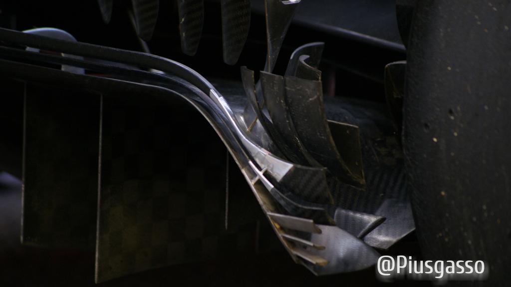

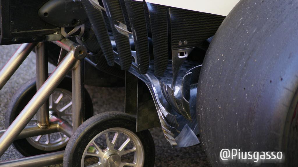

About the floor, the heat pipe idea seems the most logical and as someone said it could be very well used to heat the beginning of the diffuser (or the sides) in order to reproduce what EBD was doing. The heat pipes will go to a heat dissipator which will be used heat the airflow. A question for the aerodynamic specialists: would 80 or 90°C be suffisant to energize the flow and reproduce the famous EBD effect?
386
Joined: 16 May 2011, 15:18
Re: Scuderia Ferrari SF70H
No, you don't have anywhere near enough conductive surface area there to heat that volume of airflow, it's not logical at all, you'd have to run a large aluminium panel there at the least, if not finned too, exactly what you don't want there.
The most logical explanation is they're running hydraulic pipes through the floor to dissipate a little heat and for better packaging. The temperature strips are there to check the floor isn't getting so hot that it would deform.
Gui59
Gui59
-1
Joined: 12 Feb 2011, 15:15
Even with a larger dissipator at the end of the pipes?
Gui59
Gui59
-1
And just an air channel to flow hot air going through the exhausts at the front and exiting in the diffuser?
