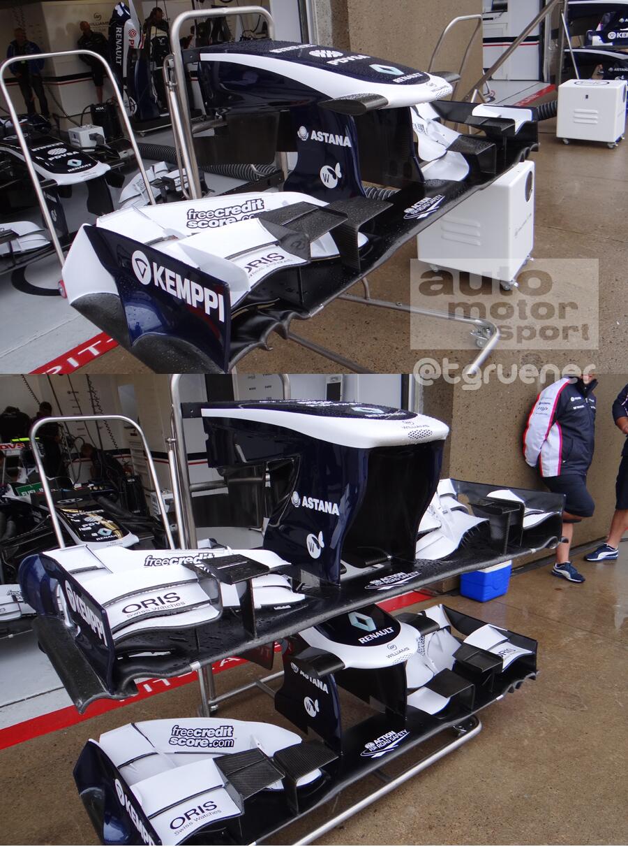

Canada 2013 - Friday (07.06.2013)
3 versions for the FW pillars
via Tobias Grüner

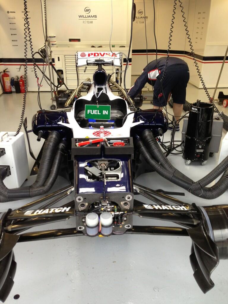

Canadian GP - Friday FP - 7/6/13
1088
Re: Williams FW35 Renault
Why Bottas continues to have an non-updated rear end?
Francesc
Francesc
50
Joined: 20 Jun 2009, 21:44
Because they have no clue about which one is better.
As far as i've seen they only tested with the lower nose today, both last year and 2013 FWs but with the lower nose.
RW there is the spoon design and a low downforce flat one (i think it was from Spa last year).
Other than that, Bottas and Maldonado continue to have completely different rear ends.
To sum up, just a big mess.

1088
Bottas with 2013 FW and spoon RW.
Maldonado with 2012 FW and straight RW.
