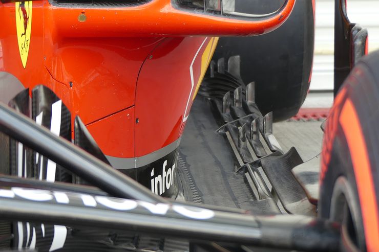

Re: 2018 aero developments
A nice touch to be able to see it from both sides.

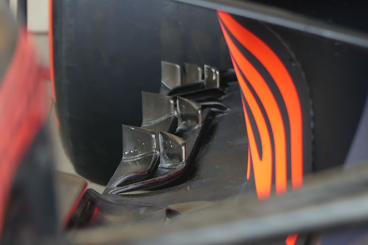

Still the masters, wouldn't surprise me if they have the fastest car this weekend.

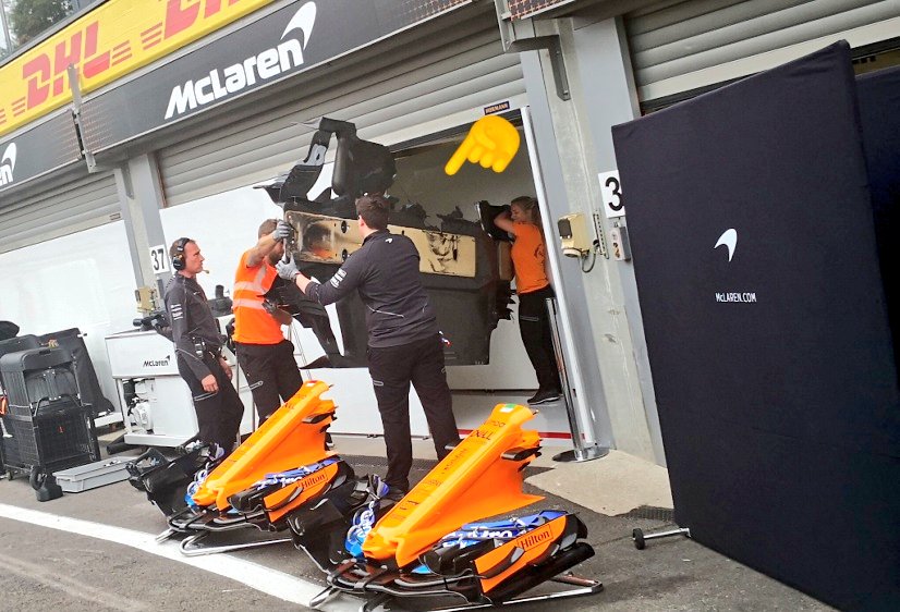

McLaren going even more aggressive with the floor slots.
MtthsMlw wrote:
26 Aug 2018, 17:54
https://pbs.twimg.com/media/DliQb-VW4AAfKq1.jpg:large
Feel bad for the ones who have to rebuild all that carnage.
