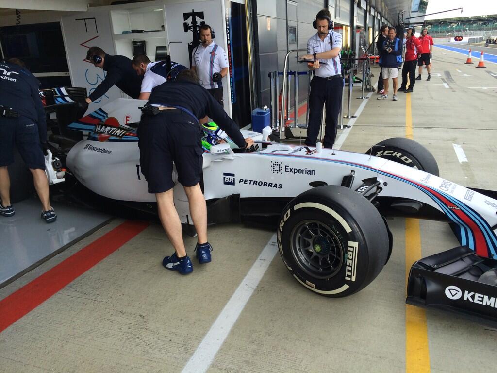

The left sidepod of BOT had an issue today. What do you think may have caused it?

roadie wrote:http://i.imgur.com/4PW3jwh.jpg
One of the Caterham's also had a hole in the sidepod/engine cover, but on the opposite side. I heard rumours it could be a turbo failure, causing it to explode, damaging the engine cover, but I thought teams had to run with a 'shield' around the turbo to protect against this type of thing?
Damage is too far forward to be a turbo, but could it be the mgu-h?

Williams damage was a problem with a bodywork fastener, Caterham the exhaust.
