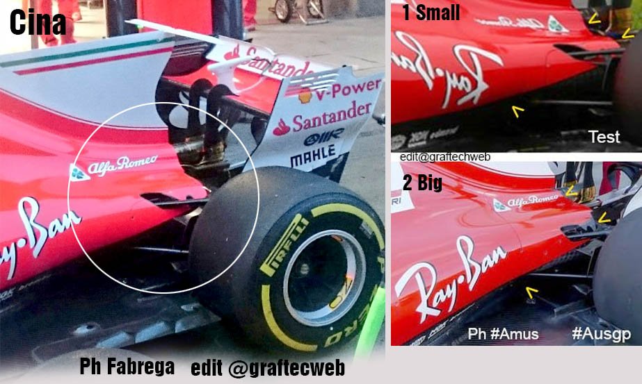

I never noticed how high the cutouts were on the edge of the floor in front of the rear wheel.

naked carbon fibre exit from X-ducts
557
Re: Scuderia Ferrari SF70H
It is said the bulge on the floor house oil cooling loops.

PlatinumZealot wrote: ↑
07 Apr 2017, 17:28
So essentially what we saw in testing only covered?

It seems Ferrari, at least in the barge board area, appears to be taking a very organic-looking approach to much of the aero compared to the sharp and jagged edges the Mercedes features. The Ferrari has rounded corners and elliptical looking aero devices all over. Appearances are of course deceiving, but it appears is a dramatically different approach than others.

f1316 wrote: ↑
07 Apr 2017, 17:56
07 Apr 2017, 17:28
I saw the covered photos but, yes.
