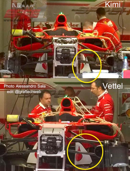

New bargebords (they are divided now):
Via @AlbertFabrega
By the way this is how the new numbers on SF70H look like (black on white):
