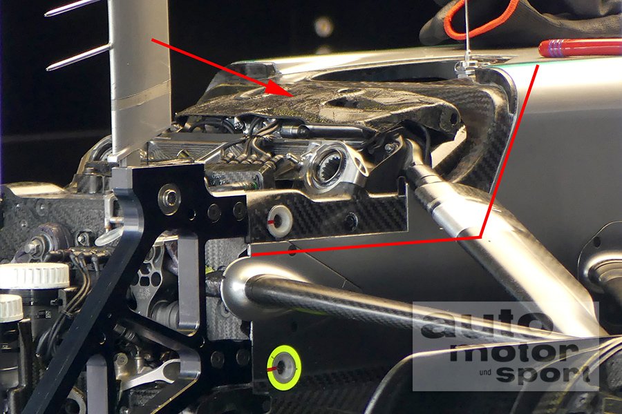

Re: Mercedes AMG F1 W07
LookBackTime wrote:https://twitter.com/tgruener/status/775609027858489344
Very interesting article!
So, in resume:
- Mercedes spent 4 years to develop FRIC system. After the ban of the FRIC system they used the experience gained to develop the new system.
- front "hydraulic computer" able to give different suspensions setup in the following scenarios : acceleration, deceleration, slow corners, fast corners, straight lines
- the system require a great deal of engineering setup experience
- Mercedes found a loophole in the regulation in order to accommodate the system the front of the car
- Red Bull has scooped one engineer from Mercedes in winter. So they were able to replicate the system. This is one of the reason they are so good this season. Renault engine still has 50 hp deficit.
- almost all the teams have the system (of course in a different level of refinement) installed on the rear suspension
Here's the AMuS picture, (with cover):
