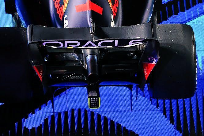

Re: Red Bull RB18
NicoS wrote:
07 Apr 2022, 15:42
This car is an absolute jewel!
From these pictures, I get the feeling that they are blowing the diffuser with the flank of the sidepod and the tyre squirt area.
They are basically ramming air into that tight space, almost like a nozzle effect. They should get more suction from the diffuser, but critically, they have a better pressure gradient between the front and back of the car to mitigate against choking.
