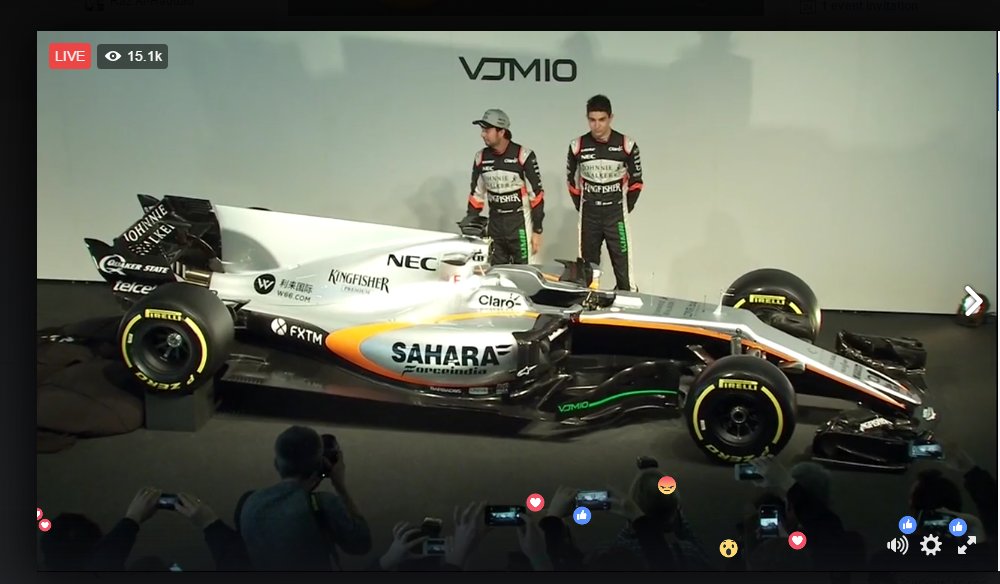

Very noticeable bump at the front of the monocoque - I guess that means it also has an HPC system as per Mercedes and Red Bull?

Looks like its an evolution of the nostril nose, very extreme step on the bulkhead

Wow looks like a very clever design on the nose, i wonder if they use these holes for an S-duct...and there is a step also...still it looks quite good and well developed! =D>

They have abandoned the S-duct while other decided to use it. Interesting.

Its difficult to see, but the sidepods look wider than the other cars

The nose features BOTH a 2012 step and a 2013 penis. This is 2017, guys!
Airbox looks like a copy-and-past from last year Merc (which will stay the same this year, should we go by the W08 teasers).

Also a big air intake as the W07 had.

Well, apparently Perez has his own Mexican wall already behind him while driving. Hardly a sharkfin anymore.

https://twitter.com/DiGomes_12/status/8 ... 8327706624 The lower, closing edge of the nostrils have been removed. That is one difference. I can't see, where the S Duct is exiting on the nose!
